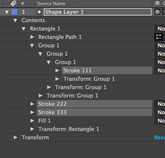

This seems so simple, but I cannot figure this out.
I have selected Stroke and Fill under ShapeLayer. And I want to remove them from this layer.
    var myLayer = myComp.selectedLayers[0];
    var propertyCollection = myLayer.selectedProperties;
    for (var j = propertyCollection.length-1; j >= 0; j --) {
        propertyCollection.remove()
However, on second iteration AE gives me error "Object is invalid". Am I missing something?
P.S. How do I paste code here so it looks like a code, and not a text?

Tomas Sinkunas
October 21, 2015
Thanks UQg‌ and @Mathias ,
However, I am not sure how to go about "sort the selected properties by propertyDepth, then by propertyIndex"
if (Object.isValid(propertyCollection) propertyCollection.remove();    <--- always returns false after first itteration.
Also, once first iteration is over, the visual selection of properties is gone. maybe that's the case?
I thought that this solution to remove selected properties will be a walk in the park, but now it's becoming countless hours of investigating why it's not working. Please, if you have a logical solution for this, please help.
