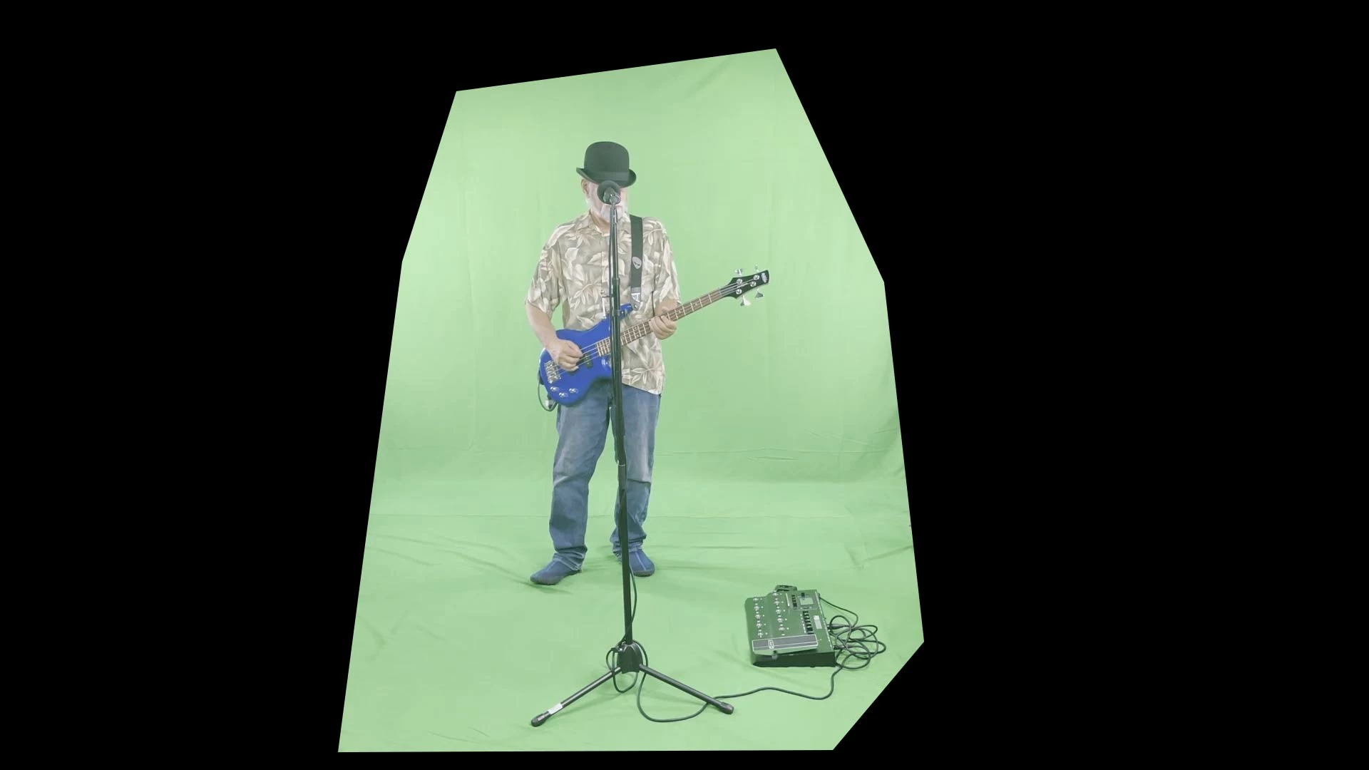

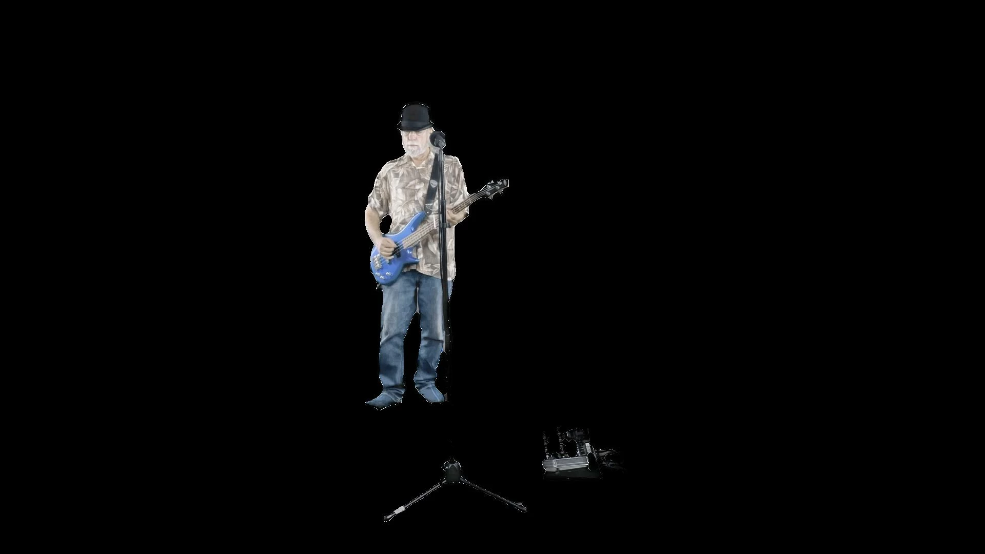

Doing some basic green screen editing of a video clip...see attached... have keyed out green via keylight, set the clip black to 15 and clip white to 50 in the Matte view to get the best minimal settings, applied the "chatter" and "green spill", shrunk image by about 1 or 2 pixels, set the, and fiddled with "screen gain" between 103 and 110...can't remove the thin jagged white edge around the image... see 2nd clip

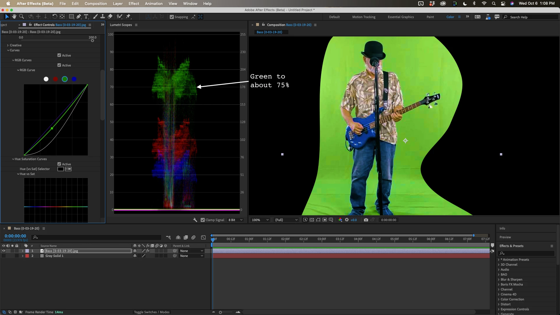

The first color grade:
I always use the Color workspace and the scopes when I'm setting up a key so I can see what is actually going on in the comp.

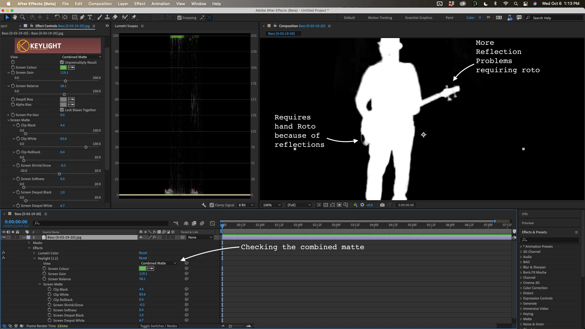

Checking the matte:
I also step through the viewing options in Keylight to make sure I am getting the best matte possible.

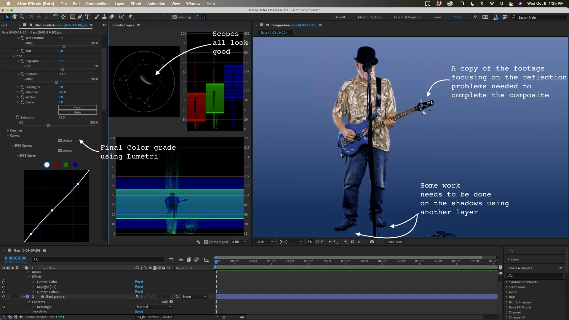

Almost the final:
Additional color grading is almost always required after you pull a key. With this shot adding a second instance of Keylight was sufficient. Sometimes I use the keyed footage as a track matte, most of the time, there is more than one copy of the original footage in the final composite.
I have had composites like this take up to 10 copies of the original footage and a bunch of different techniques. The footage is pretty good but could have been exposed a little better, but the frame you shared is good enough to get a good key if you work at it a bit.
