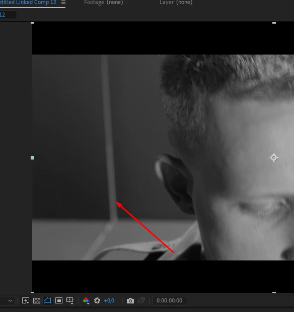

Hi! I've been trying for a long time to figure out how I can remove these white stripes and make the background more uniform. I tried Stamp, but because of the speed of movement, a lot of work needs to be done, processing each frame separately. Content-Aware Fill does not give a very good result, which I can fix by using Fast Box Blur, but it does not always work and is also not very convenient. I am sincerely sure that there is some concise and correct way to solve my problem, but I can't find it in any way. Please share your thoughts and ideas, how do I solve this problem?

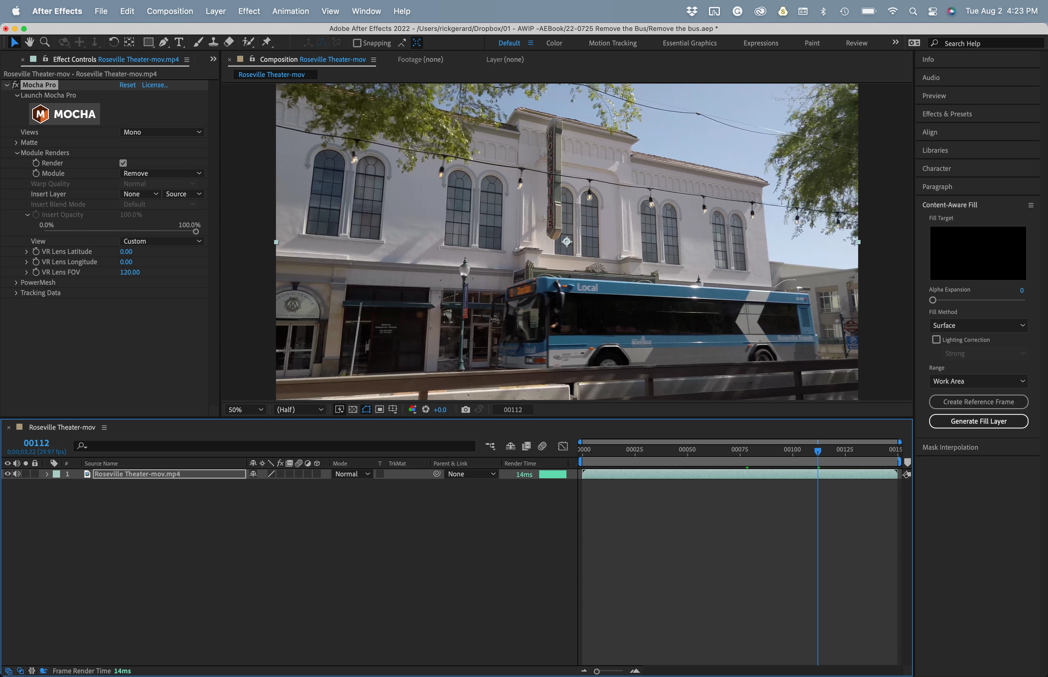

I am working on a tutorial that covers removing background and foreground elements using everything from Content Aware Fill to Mocha Pro. I will try to remember to post a link here when it is ready. Here's a short teaser. Before rendering the Mocha Pro Remove module:

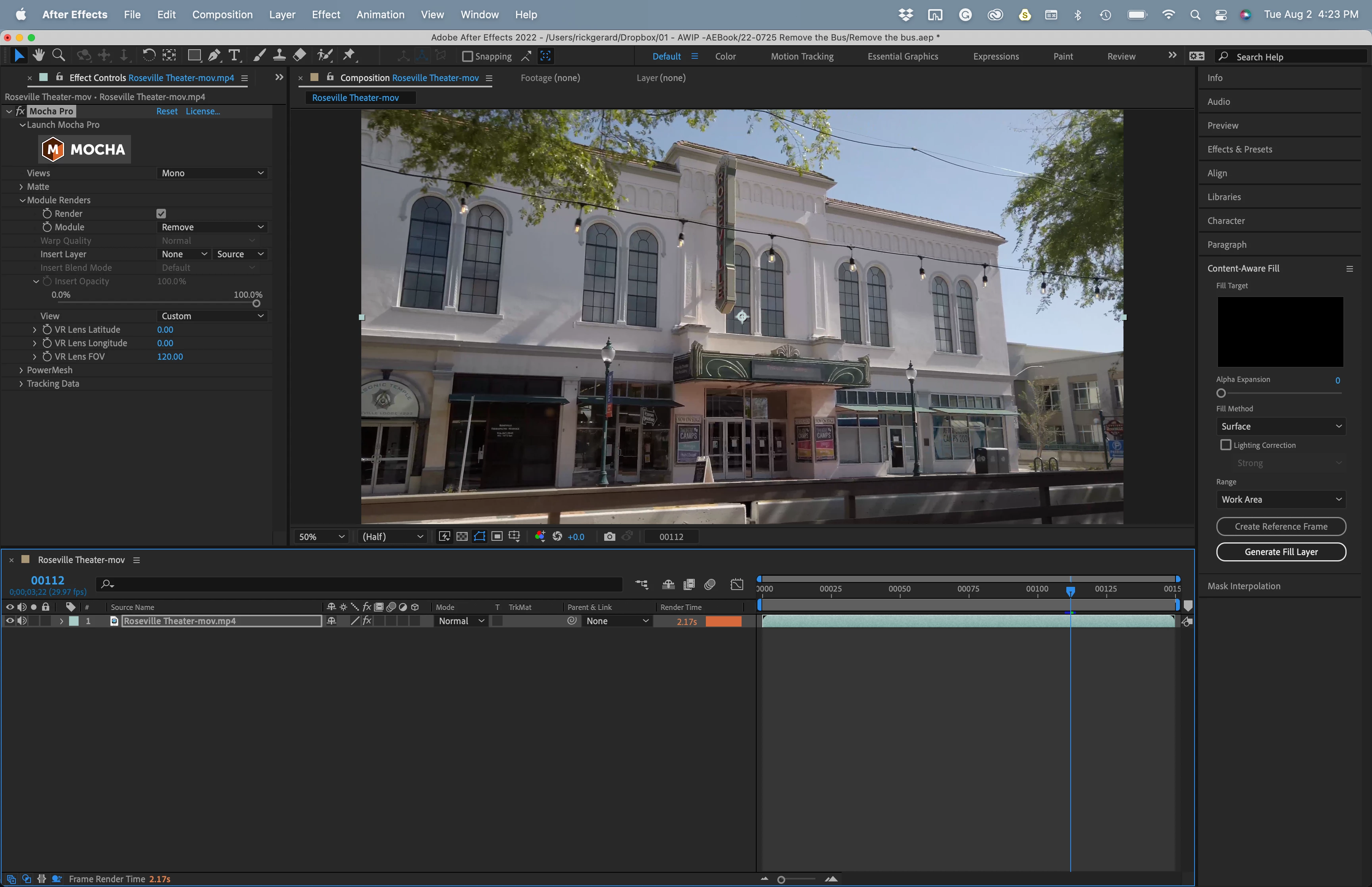

After:
That shot is a dolly shot with the bus driving through the scene. It took 4 hours to fix the 150-frame problem, proving that almost anything is possible if you use the correct workflow.
