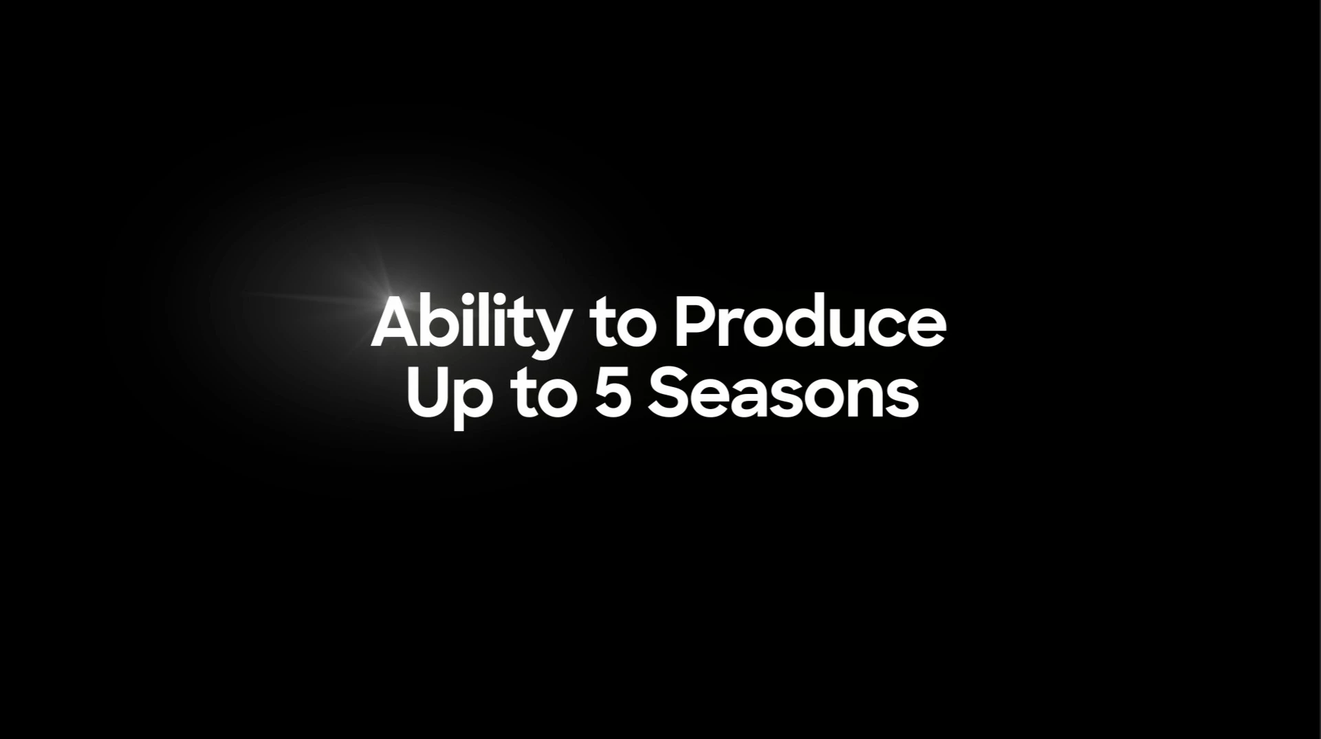

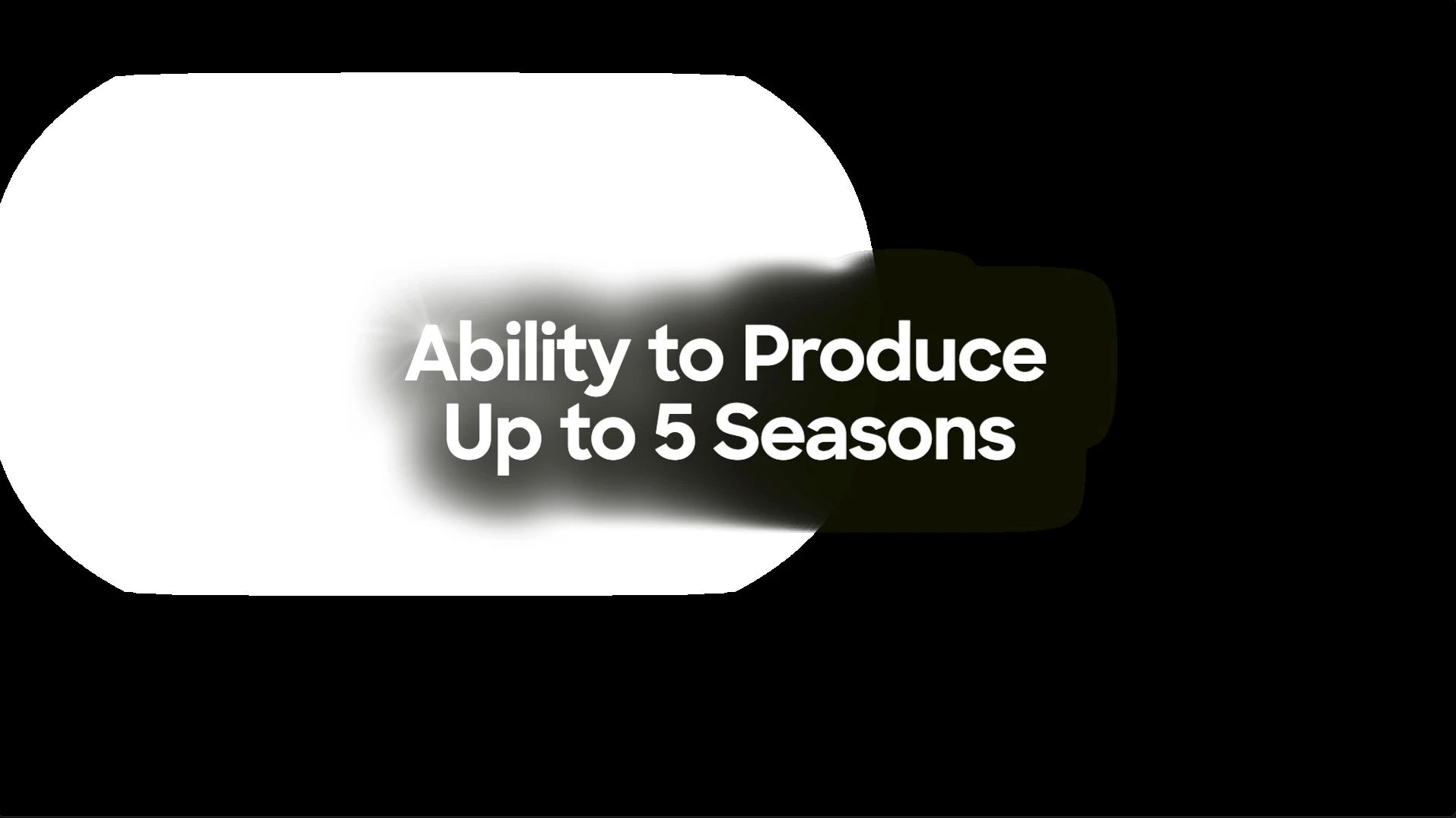

November 4, 2021
Having the same problem - very simple animation with alpha fails. Interestly some of the comps rendered fine, some failed then tried again and rendered fine.
Media Encoder did render them out and they were fine. What artifacting did you see? Are you sure it wasn't just artifacting from the straight alpha? I noticed that the new OS (or maybe just the M1) shows the full alpha when using quicklook (or quicktime) and on my intel mac (Big Sur) it would let you preview the file showing what it would look like composited.
Have you tried taking the files back into AE and dropping them on in a new comp?
This is what quicklook (and quicktime) shows the rendered file:
This is after bringing back into AE:
Regardless, there is definitely a bug in the new AE 2021 with this 9988 code which is hopefully fixed soon!
