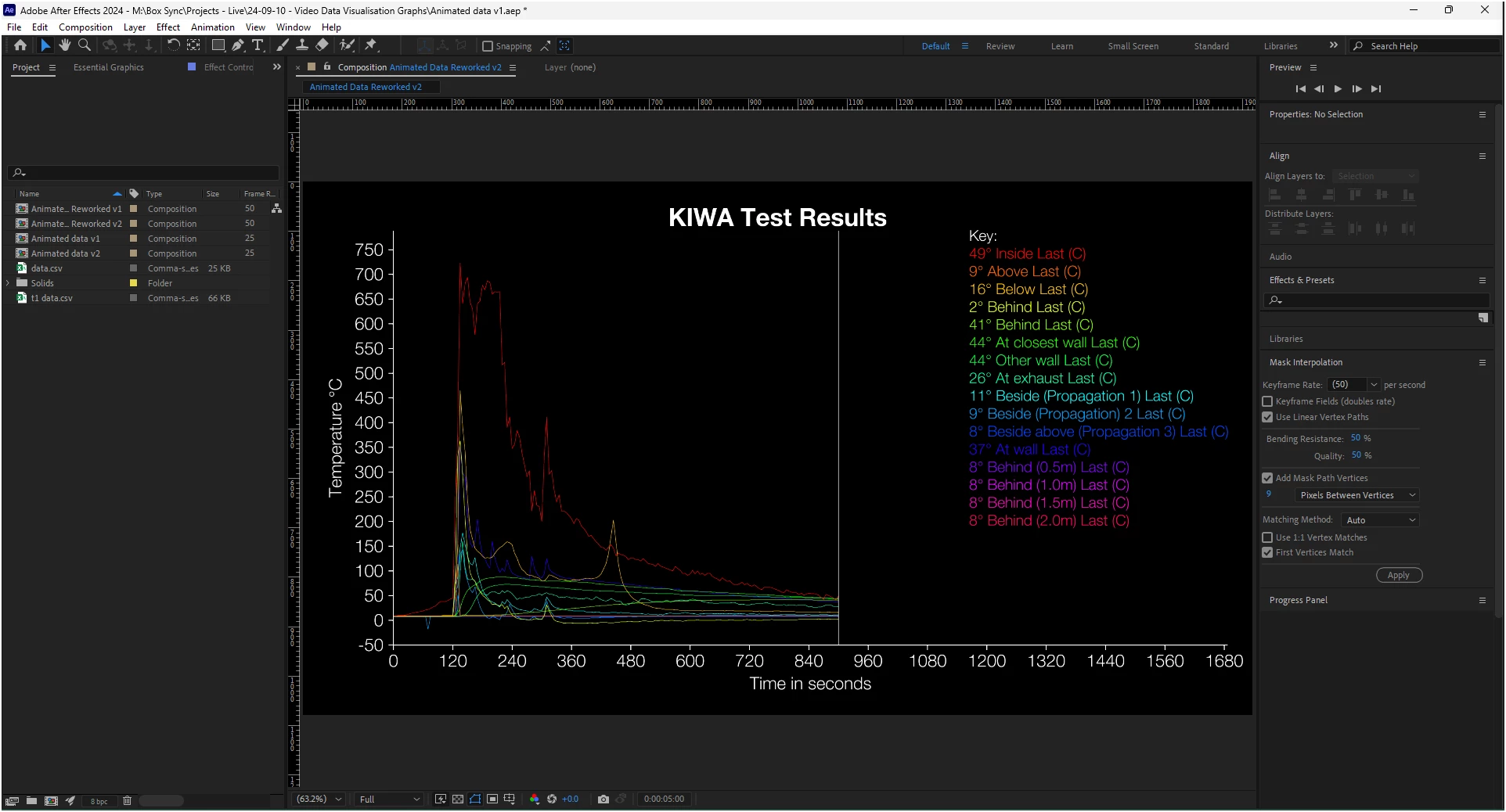

This is what I'm seeing in AE, and what is should look like.  The playhead moves as you play, and the data paths only draw up to where the play head is.

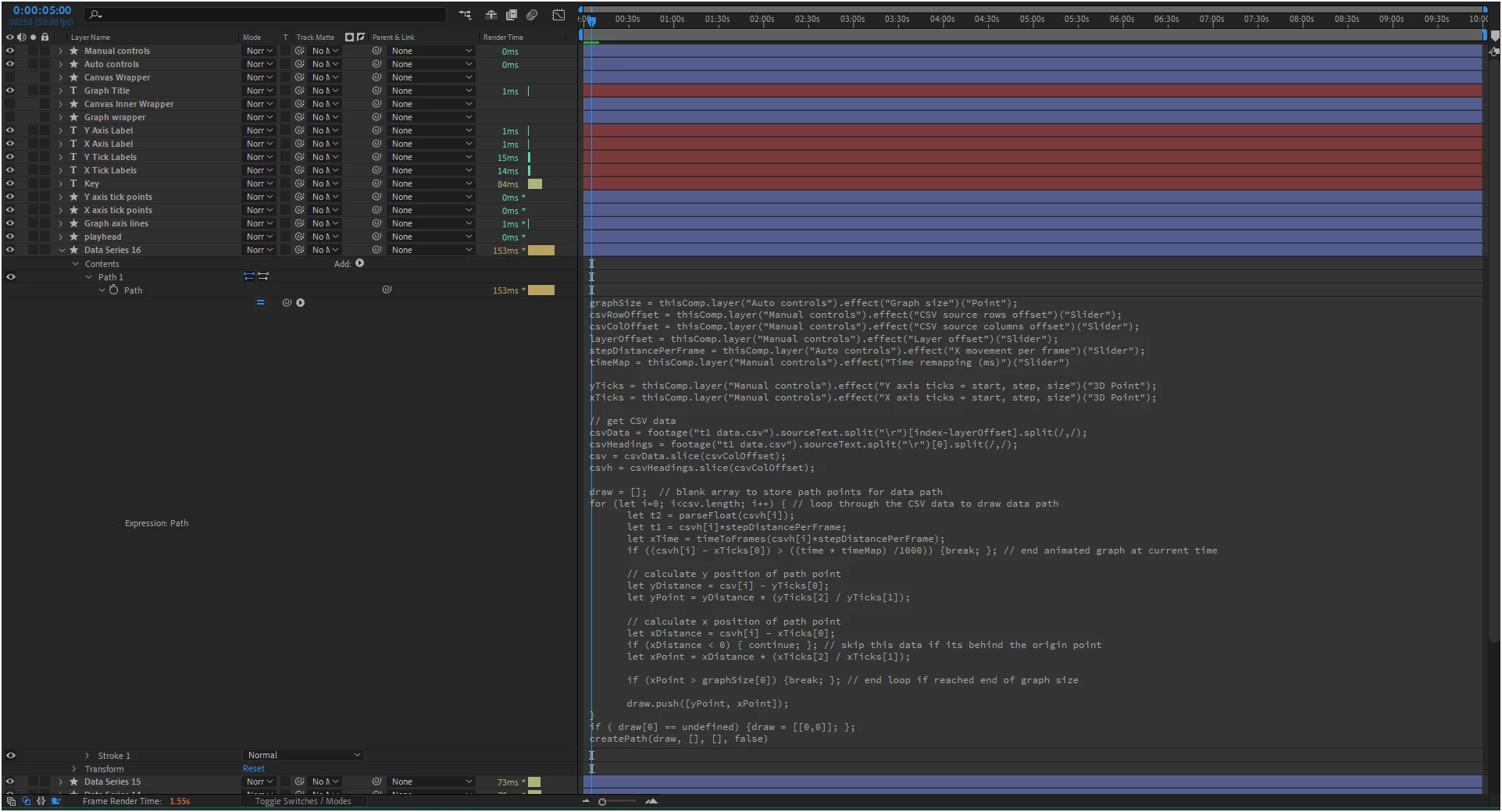

This is my second screen showing the layers and the logic behind drawing the graph path.

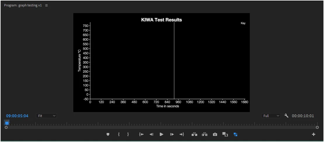

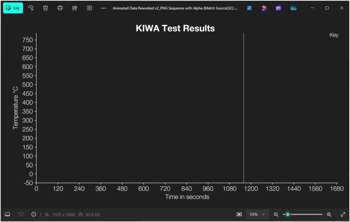

When I render it out however (as a sequence):
No data paths.  Shows the same in Premiere using dynamic link to add the comp.  Occasionally I'll get a preview in Premiere Pro showing correctly, but the export never contains the data paths.
Premiere program window:
