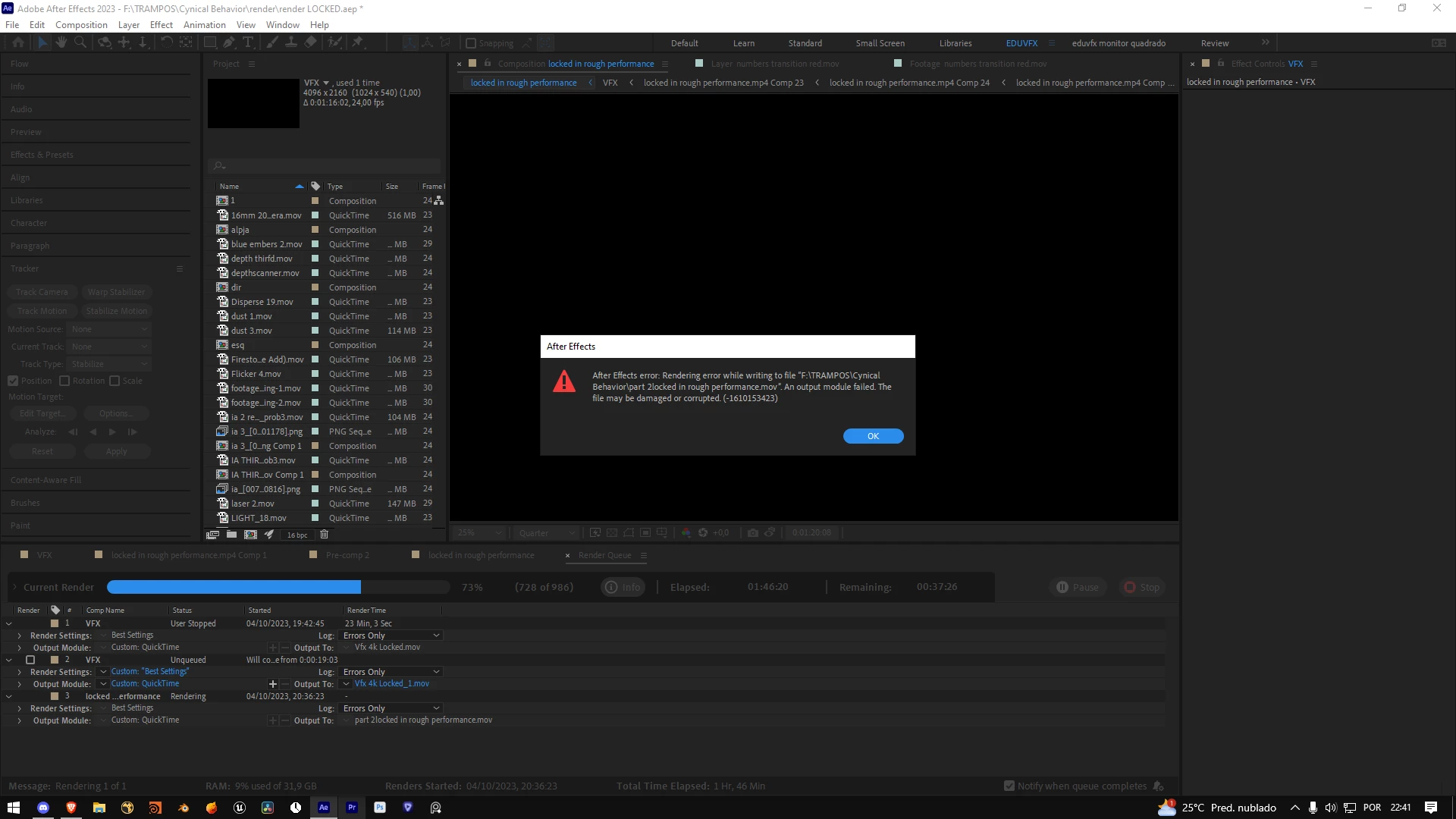

render slow
In addition to taking a long time, I got this error before completing the render.

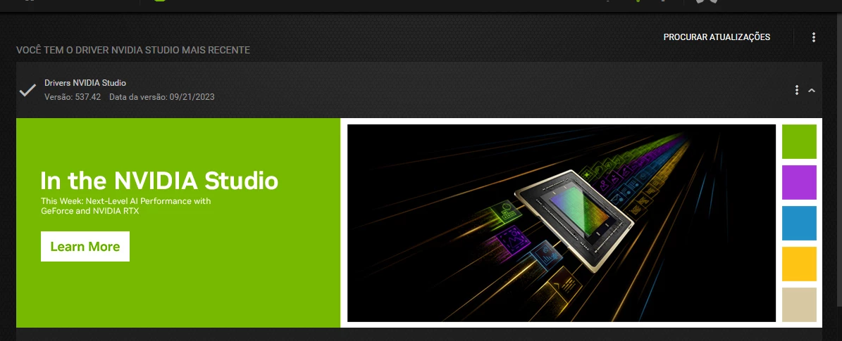

Oct 6, 2023 1:44 AM UTC
It says here what caused the crash but I still don't know why my renders are so slow, which Nvidia driver do you recommend?

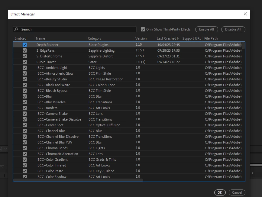

Oct 6, 2023 12:12 AM UTC
The crashing call stack indicates that Element is being used. Go to Effects -> Manage Effects... and then disable Element. Restart AE and see if that helps.
Oct 5, 2023 11:37 PM UTC
but in this project I did not use the 3d element at any time , minha versao de drivers:
Oct 5, 2023 10:56 PM UTC
Thanks for sending the log. Looks like a combination of NVIDIA drivers and Element 3D not working well. Unfortunately AE is just at the mercy of both the driver and the plugin working correctly and it's not.

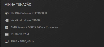

Oct 5, 2023 5:15 PM UTC
Do you have enough disk space left on your machine? Can you share your machines specs? Can you create a log file so we can get some info on what's happening in the render?
