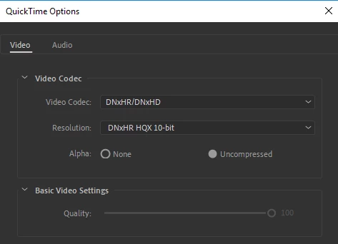

    Hi Roland thanks for your reply. I have 2 different layers of twinkling lights, and a layer with a fire. I set up pre render on each just to test them. The 2 lights give estimated time of 25mins each approx while the fire give estimate of 8 hours, so the fire obviously the problem. (all were done using particles. My question is now , if I pre render the fire what  should I output it as, i.e.: .mov or mp4 if I want the background transparent so as to place fire over other still images. My fin outputs will be as mp4s for complete background.
    Thanks
    Roland Kahlenberg
    November 12, 2018
    Most users use QuickTime with either DNxHD, Cineform or the Animation CODEC. These CODECs support alpha channel - ensure you set the output module accordingly.
