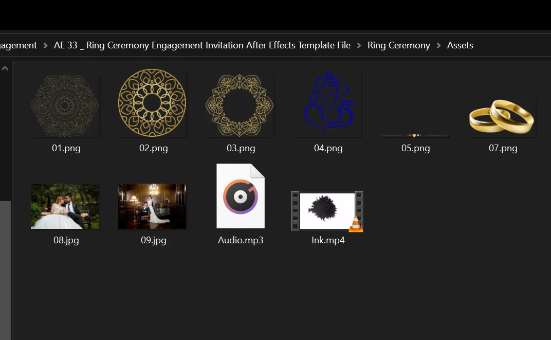

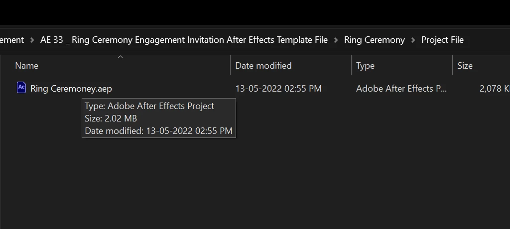

Thank so much Rick sir. I got the idea.   And I am posting this file but after doing so it actually increased time.  Here is the folder structure. Which Codec and which faster to re-render things. Please look at thiss file.
