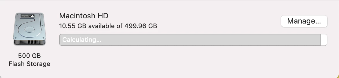

Start by freeing up disk space. Chances are AE is suffocating because it struggles to store the final output file and any temporary files and caches. 10 GB storage is literally nothing in this day and age. Aside from that it may help to adjust your expectations. No offense, but you seem to have a wrong concept of how AE works and what it is primarily meant for. It's simply not designed to wiz through stuff in realtime and even if you only have a handful of layers, you have some fancy processing there with your glows and particle effects. Even if a single frame only renders for 5 seconds or such, processing almost 10000 frames for your 3 minute piece (assuming 60 FPS) will take several hours. These caclculations may get more and more complicated as effects accumulate data like particle systems spawning particles over a long period. So for what it's worth: None of this is unusual in the AE world and perfectly normal.
