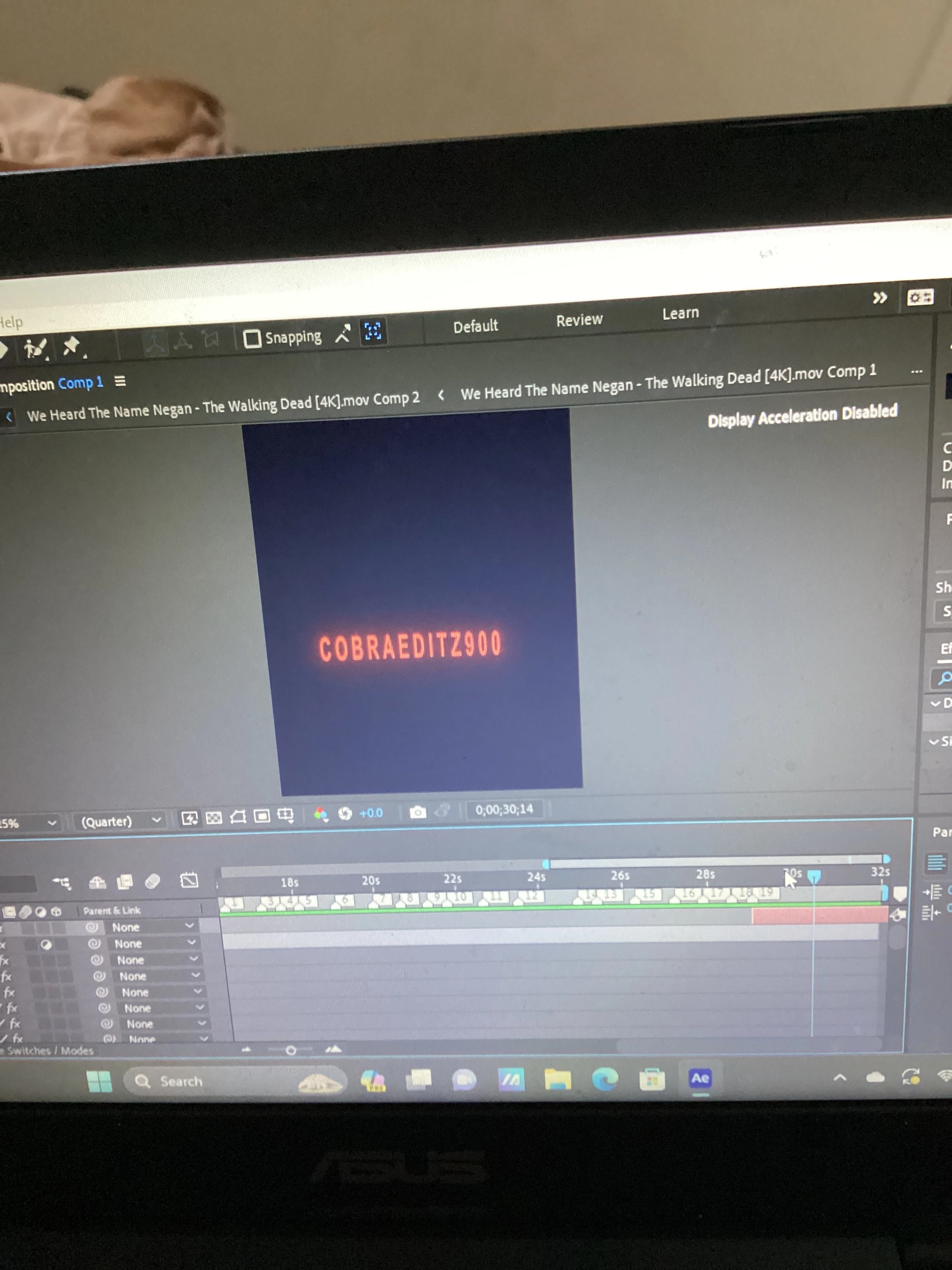

Rendering process gets stuck at a certain percentage.
When I try to export a project the rendering process is stuck and won't move for example it is 8%/ 86/960 frames.The only way it moves a bit is when I turn off multi frame rendering but it doesn't really help.
Render settings: best settings
Outpt module: QuickTime
RAM: 82GB
