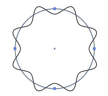

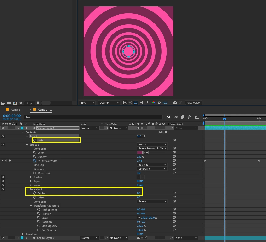

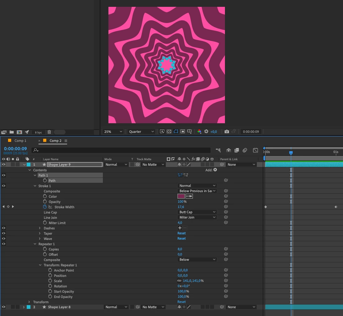

@leo_5106 I might have an idea for you. First try to create your animations just with one shape layer and a repeater. This way you could swap out the circle for other shapes. To swap out the shapes create an empty shape layer and add a path in AE. Then create your shapes inside Illustrator at roughly the same size and copy the illustrator path onto the After Effects Path.
Then copy the next Illustrator Path and paste it into the AE path …
As Lottie will not support the repeater you have to “convert” the repeater into separate shape layers before exporting. There is a script on aeScripts that can do that: https://aescripts.com/shape-repeater-baker/
I attach your AE file with a second comp and the AI file for you to experiment with the path replacement before you consider this option to work for you.
