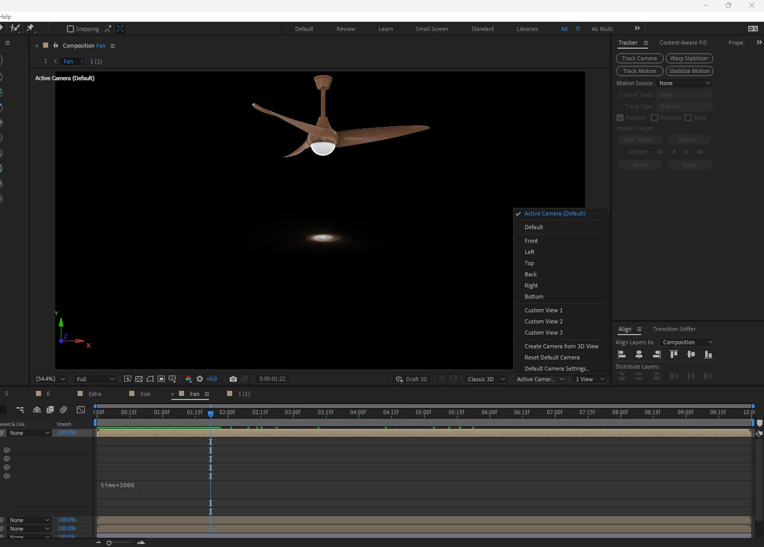

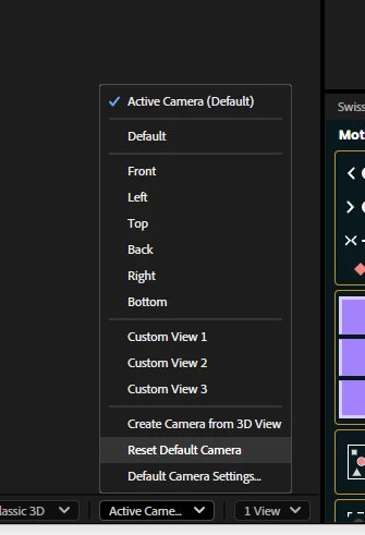

I ran into this as well using the orbit scene tool. if you do not want to create a camera you can find the reset here(under camera view tab) in the comp panel.

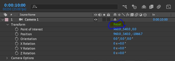

Select your camera Layer and Drop down the options. Within Transform, click blue "Reset" button.

you can reset the default camera from the viewport camera settings

View>Reset Camera View if you aren't using a camera and are using the Orbit Around Cursor tool. Perhaps you're using the word "camera" and not "view" and that's what's causing the confusion?

See answer above... the issue is how to reset the 'camera' when there is no actual camera layer – sometimes you just want a pre-comp containing 3d elements and no camera layer 👍. If you use the orbit tool in a comp with no camera layer it still adjusts the 3d view of the scene. If you got to 'view -> reset 3D view' it fixes the issue.
Apr 14, 2021 4:21 PM UTC
You don't need to have a camera layer to use the Orbit tool. Hit "Reset 3D view" in the View menu.

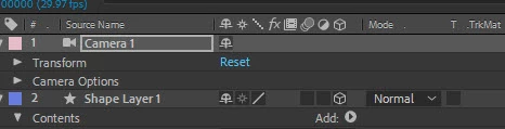

I even find it a tiny nit surprising that it even gets asked because twirl open the camera options there's a bright blue word that says "reset"
Also as is the case with any property in After Effects you can right click and choose reset.  That way if you wanted to reset only some properties but not all you easily could.

Have you tried the "Reset" option in the Timeline?
You can create a shortcut to this reset feature in the Keyboards Shortcuts Visualizer - I've set mine to SHIFT+Z.

I don’t see any answers here, did you post this in another thread? If you want to reset your camera simply press UU
so you collapse the modified properties and right click on them ->reset on the properties. This is if you are in active camera view. If you want to reset any other view it’s in the view->reset 3d view.
