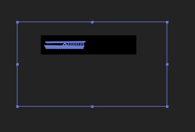

Hi there,
I converted an AI asset to a shape layer and can't figure out why the bounding box is so much larger than the layer itself. It's also not letting me select and edit individual assets within the layer. Any help/insight would be greatly appreciated. Thanks!

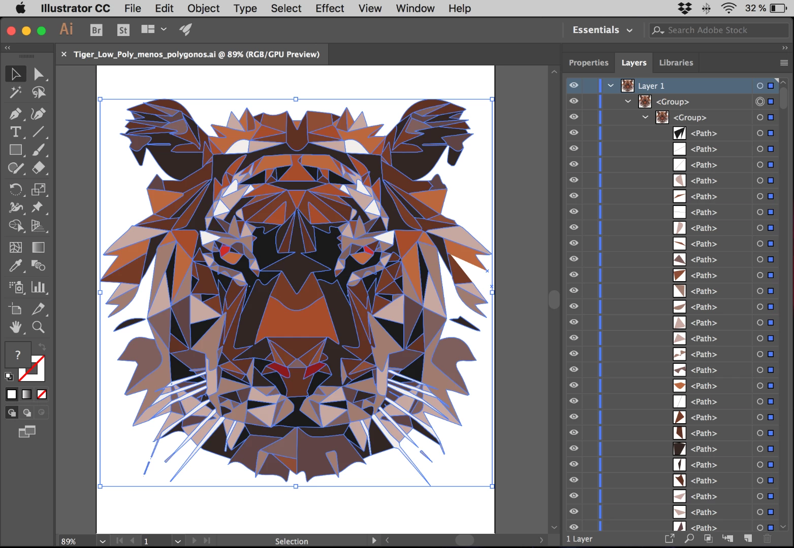

Apr 15, 2018 3:10 AM UTC
Hi
In Illustrator, the groups in your Layer should look more or less like my screenshot. And when selecting your chart your Bounding Box should only select your chart. Something like my screenshot.
Regards!
Byron.
Apr 15, 2018 7:20 PM UTC
Thanks for the help! I appreciate you showing me a proper example.
