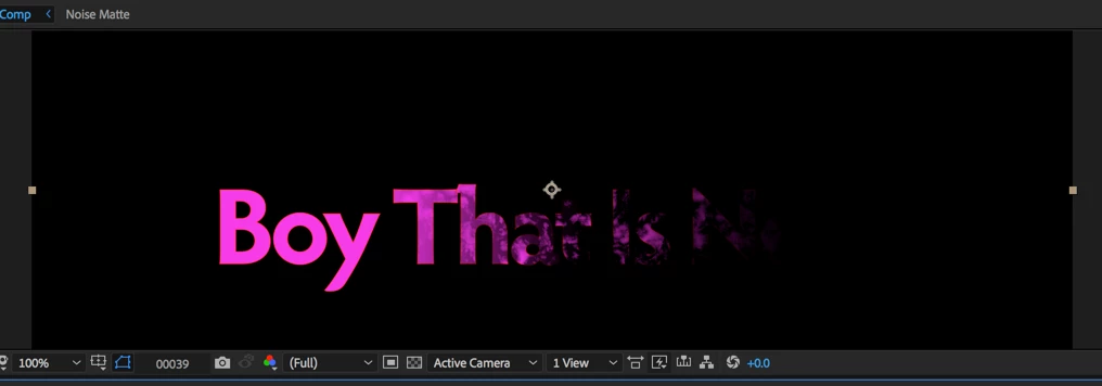

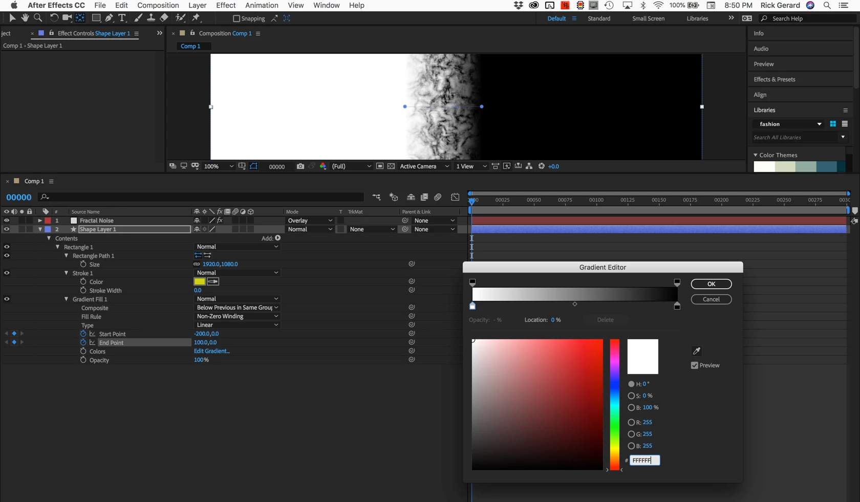

I would set up your fractal noise layer with the kind of animation you want and then set it on top of a shape layer with a gradient fill. Animate the start and end points of the gradient to get your wipe, set the blend mode for the fractal noise layer to overlay and end up with something like this:
This comp just needs to be slightly larger than your text layer. When you have the white to black comp animated add it to your main comp and use it as a luma track matte for your text layer. You'll end up with something like this:
This is only one of a couple dozen ways you could recreate the effect. Here's a project file for you to play with:
