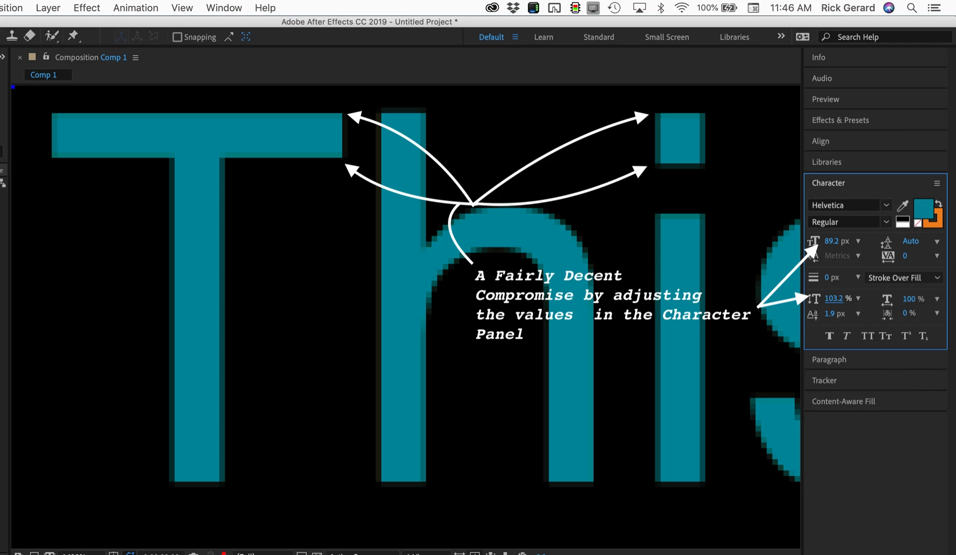

      • Make sure that the font is thick enough to avoid antialiased top and bottom edges of the majority of the characters
        This:
        Becomes this with a little tweaking and you can see it at 800% magnification factor:

    Perfect rolling credits - Hollywood style:
        This:
