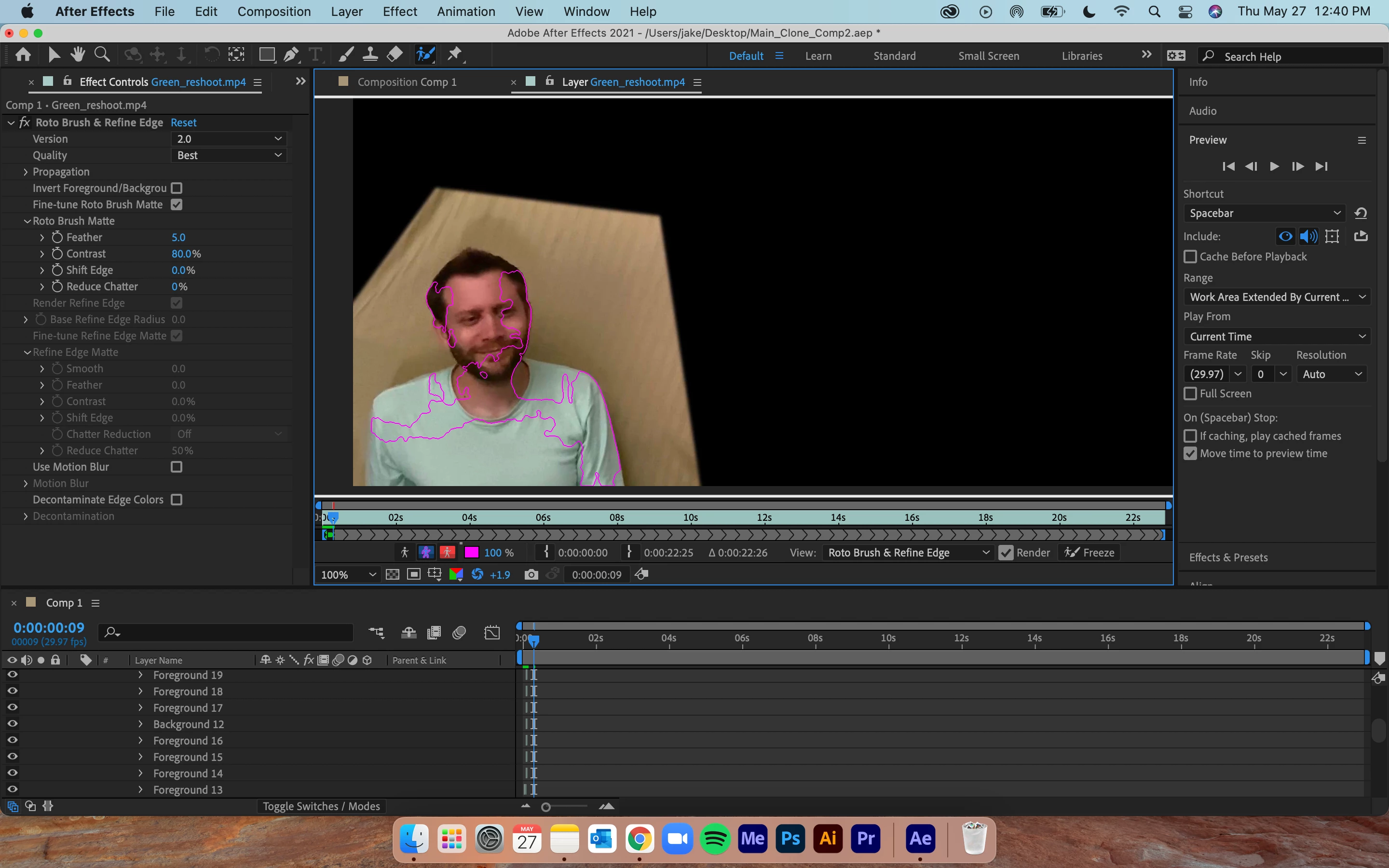

I'm new to After Effects so I'm just as new to the Roto Brush but my friend who uses Roto and the tutorials I've seen don't take nearly as long to freeze. It starts off quickly but then slows down usually at the 5% to 10% mark then it's very slow. I think the longest it's taken to freeze the roto was approximately 6 hours for a 23-second clip! I let it go the whole time because I wanted to see how long it would really take. I'm not doing anything very complicated either. I've noticed that it takes longer to propagate than what most have described and what I've seen in tutorials. Here are the specs I'm working with:
MacBook Pro (13-inch, M1, 2020)
8 GB Ram
Mac OS: Big Sur 11.2.3
After Effects CC: 18.2.0 (Build 37)
67% used of 8 GB
aep File size: 46 MB
Duration: 23 seconds
Any help would be so grateful.
Thanks!

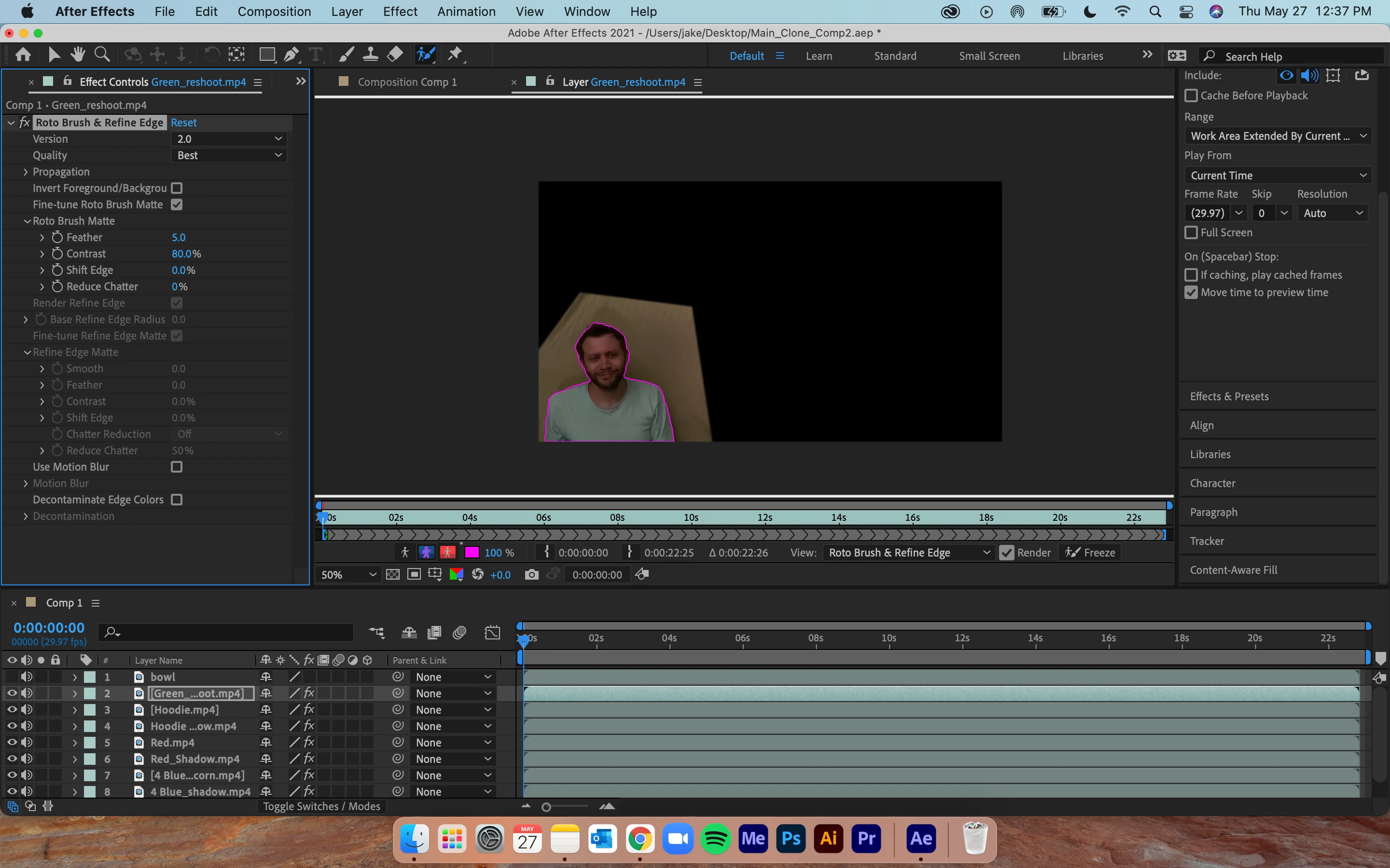

That is solid advice! I really appreciate your input. I'm a big-time noob at video editing. I reshoot the last layer that I needed and it made a world of difference but I'm going to need to put it on its own comp as you said and do the rest as you can see in the second image the reshoot wasn't perfect but a lot better. 😂
Thank you so much, Rick!
