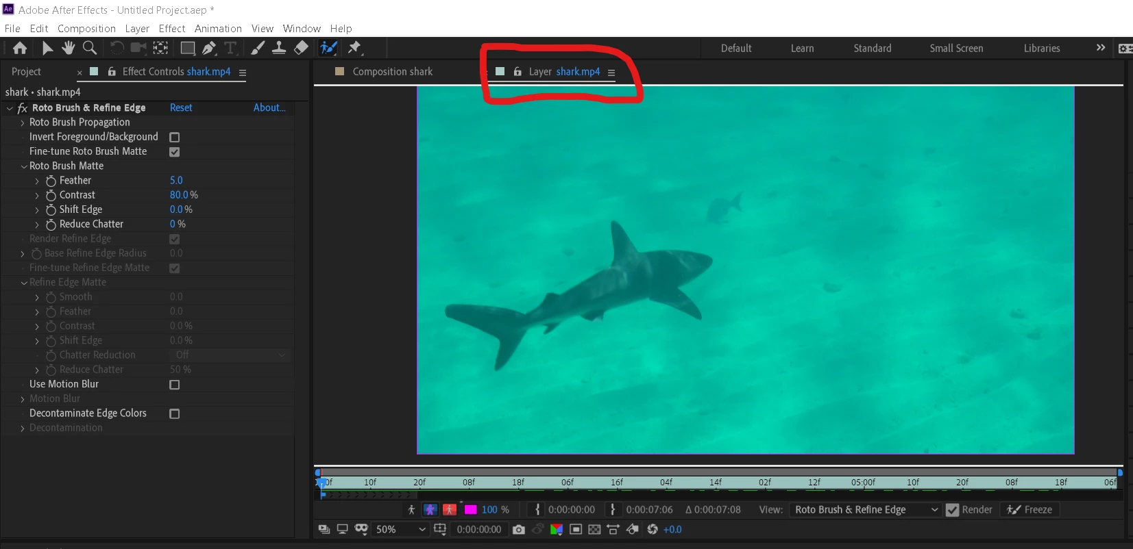

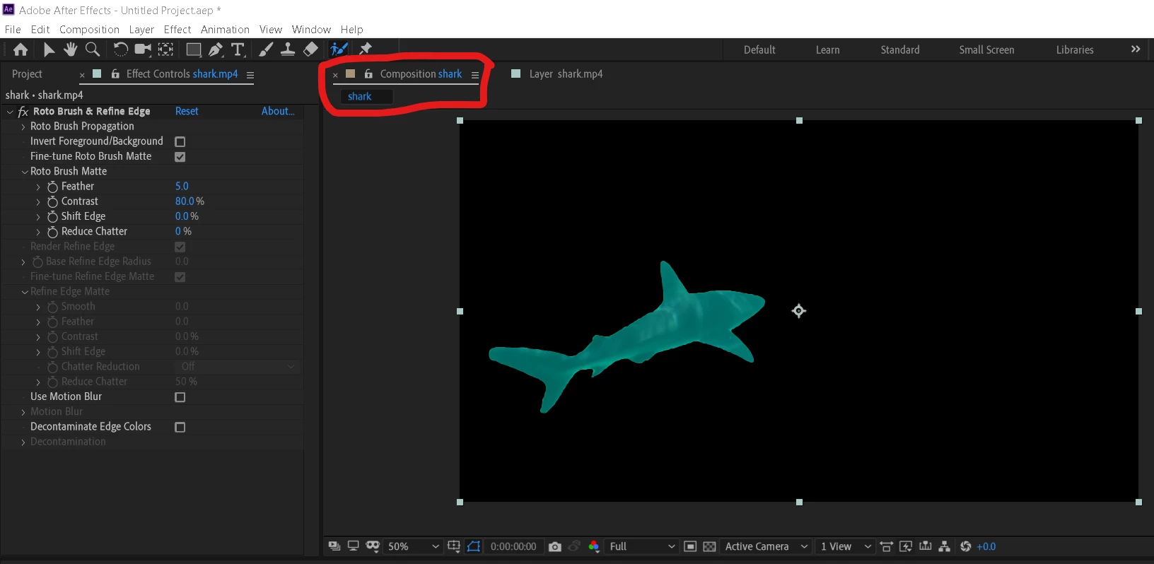

Hey group !! need help from experts. I'm using after effects CC 2019 and when I use roto Brush tool it's not showing selctions lines which I selected but roto do his work and display result in real time playback windows but not showing any lines of selction in composition playback of that particular windows and also I wanna add that when I'm pressing roto brush to select object as long as I clicked I can see the selection lines but when I release mouse button the lines disapears

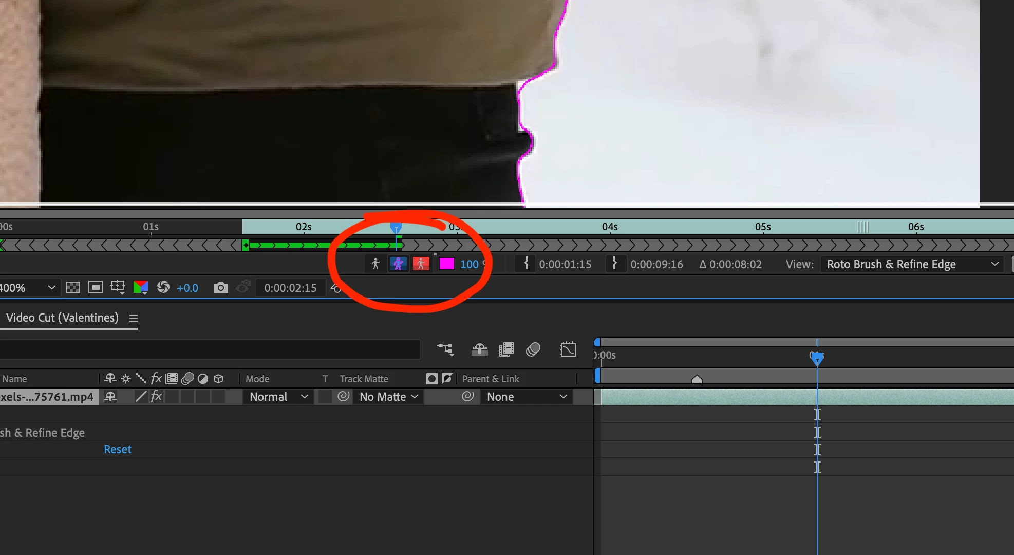

    I try it all the solutions commented but none worked, if anyone have the same problem in 2024 (24.3.0 version), just restart the computer and it's done!
    January 31, 2023
    Try switching between these toggle... Maybe this might help? 🙂
    November 1, 2023
    Yes, yes. This is correct!
    July 8, 2022
    This seemed to work for me:
    1. Turn off the "Roto Brush & Refine Edge" fx toggle in the Effect Controls panel of the layer you're rotoscoping.
    2. With the "Roto Brush Tool" selected, click and drag on the layer. (A new instance of "Roto Brush & Refine Edge" will appear in the Effect Controls panel) - The pink selection line appears again.
    3. Undo/Delete the new effect.
    4. Turn on the previous "Roto" effect. - The pink selection line should appear again.
