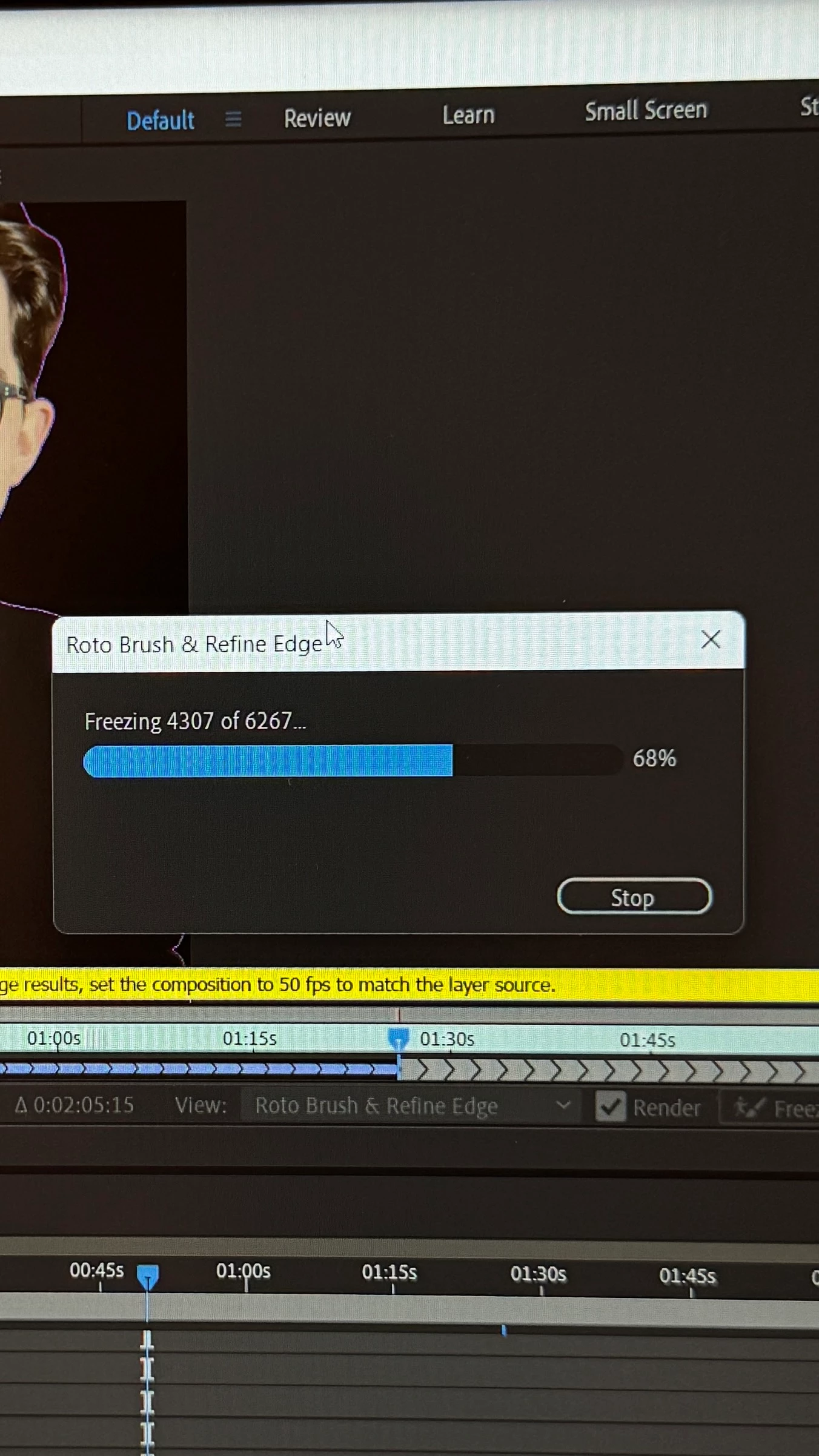

I’m using After Effects on my ROG Strix G15 with 16GB of RAM, intel core i7, GTX 1650ti and Windows 11. When I try to remove a background from a three-second video and click ‘Freeze,’ the rendering process involves around 6000 frames, which takes a long time.
Steps to Encounter the Bug:
1. I import a three-second video into After Effects.
2. I select the area of the video from which I want to remove the background.
3. I click on ‘Freeze’ to start the background removal process.
The program should render a reasonable number of frames, like my brother’s laptop, which only processes around 170 frames, making the rendering quicker.
What Actually Happened:
The program is rendering approximately 6000 frames, leading to much longer processing times.
How can I reduce amount of frames that my laptop needs to render?

Your clip appears to be 3 minutes long, not 3 seconds long.
Try trimming its duration in the Footage Panel to just the portion you wish to use.
https://helpx.adobe.com/after-effects/using/footage-items.html

You are right. It was rendering 3 min raw video, not just the part I needed. Thank you!

I was trying to use Roto brush to remove background from 3 seconds part of whole video but when I tried to double click on my 3 seconds clip nothing happened and new layer where I can use roto brush wasn't crated like it was in tutorials on YouTube. Double clicking on whole video (3 min) worked indeed.
I know I can trim exact part from this whole raw video, but it will take a lot of time every time just to find part you need.
so do you have any suggestions how I can remove background just from this 3 seconds part?

@Ivanna36328144cud7
Try double-clocking while the Selection Tool is still selected.  Then switch to the Roto Brush Tool after the Layer Panel is open.
