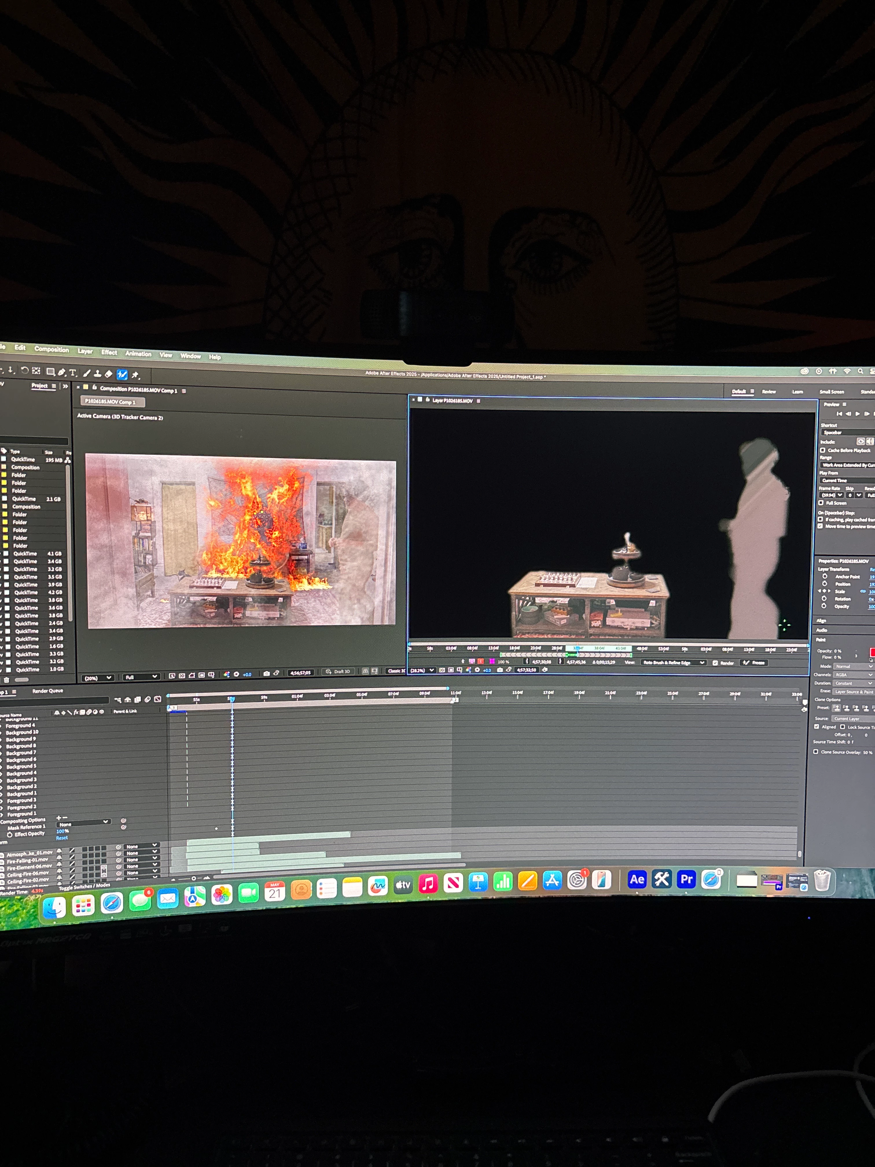

Hello, I was using Roto brush got everything that I wanted and froze it however, when I played it back, my subjects body goes transparent for a frame so I jump back into after effects to try to roto brush this one frame I don't really know how to properly unfreeze? or to tell if it's unfrozen? And secondly, now my Roto brush layer everything is blacked out except what I already wrote a brush. How do I turn off that?

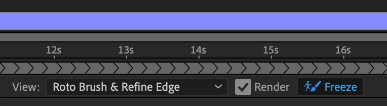

To paint more brush strokes with Rotobrush after it's been frozen, disable Freeze.
You'll know it's disabled (unfrozen) because the Freeze button will not show as blue.  Also, you'll be able to paint brush strokes.

As far as your screenshot goes, it looks like you may be using the Layer with Rotobrush applied as an inverted matte target for another layer.  Unfortunately, it's not so easy to tell from your screenshot.  Check the Track Matte pop-up menu for the Layer with Rotobrush to see if it's set to "No Matte" and for other Layers to to make sure that the Layer with Rotobrush is not a Track Matte Target.  Another possibility (but less likely) is that the background was painted with the Rotobursh.
As layering starts to get complex, I find it helpful to use the Solo switch to temporarily view specific Layers and isolate what is or is not visible.
