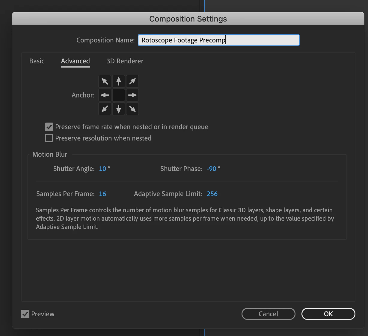

As KoMaruyama Say's, you should have the same frame rate for all your compositions
Ko.Maruyama
April 30, 2021
If your precomped footage of the rotoscoped material isn't the same frame rate (or a stretched frame rate) in the main comp, the collapsed function may be changing when those roto keyframes land.
In the Preomp's Composition Settings, make sure to check "preserve frame rate" - that may solve the issue.
