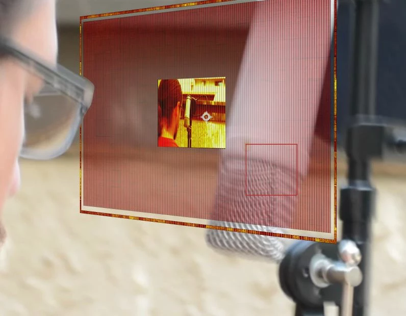

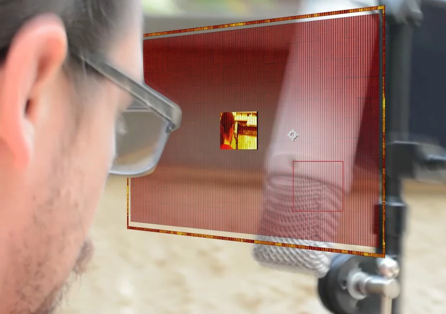

I was looking around youtube to try and find a way to do rotoscoping seamlessly. Im trying to move a "hologram" ive made and while the camera is turning around the object. I still get camera blur and it looks like its not quite believable. I tried using AE Mocha to track instead of using a null object cause its easier. but I found out it doesn't track quite as well. Any tips, tricks, or any kinda tutorial to make it look like it was part of star wars or something?

Fair enough. here are the 2 examples.

I'm assuming you are rotoscoping the edge of the actors face. Any time you roto something that is moving in the frame you have to figure out a way to match the camera blur on the mask and even more importantly, on the subject - your halogram. The best technique depends entirely on the shot and on the motion.
If I'm understanding the shot properly and the camera movement then your best option would probably be to use CC force motion blur on the matte and also on the hologram. Other options include directional blur and feathering the matte. Since you didn't provide a screenshot of the entire AE UI with the modified properties of the layers you are having problems with this is only a guess. It would also help to see the video instead of just a couple of screenshots.
Maybe this tutorial will help a bit. It shows how I matched the look of some inserted video. I've cot a couple more motion tracking and compositing tutorials in the works that actually cover this subject but I'm in the middle of a production right now so you'll have to wait.  I'm guessing about the camera movement in your shot and I think the mocha tracking technique is not the right approach to your problem, but the end of the tutorial where I match the insert to the video may be helpful.
