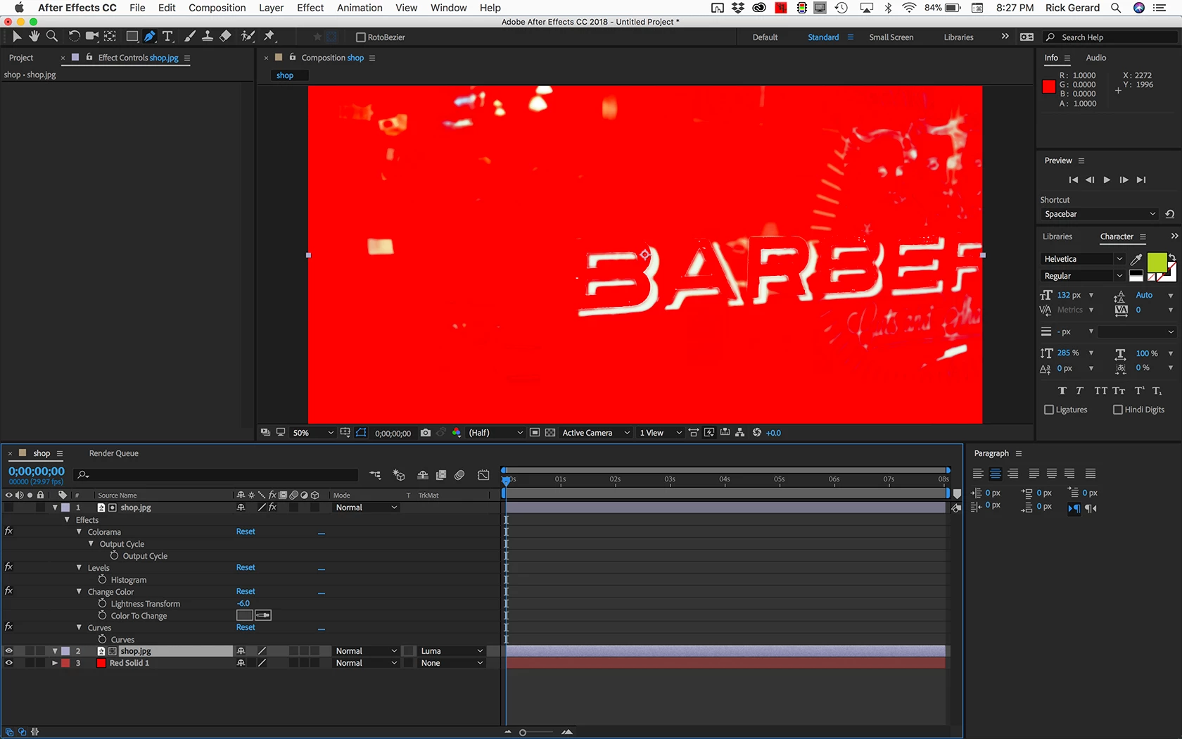

Ok, the first thing you need to do is vet your trainers. The guy in the fixed link rotoscoping a shot of a guy in a mask does not know what he is talking about and his workflow is incredibly inefficient even for the shot he is working on Drawing a mask on an adjustment layer for roto is almost a complete waste of time.
Let's start with your problem. First, I'm assuming that the camera is moving. If it were locked off you would not need to set any keyframes. With every roto project, you want to analyze the shot and try and figure out the easiest way to do the least amount of masking. There may be too much going on in that shot to try and create a procedural matte. The roto work is complicated by the decal on the window with the guys in white and the script text. If the text on the window is supposed to be sharp the white decal would also be sharp. The first thing I would do to minimize the workload of the roto would be to Motion Stabilize the shot for position, scale, and rotation using the text for tracking. This may completely eliminate the need for animating mask paths. You may need to temporarily increase the size of the comp to keep the shot in the comp panel. The procedure would be to add a colored solid to the comp above the 'stabilized' layer then set a blend mode like multiply so you can see through the solid, and then do your hand masking on the solid layer. You'll use that for a track matte later. If you are stuck with hand roto and a moving camera 90% of the time motion stabilizing the shot is a wise move. It can save you hours.
After motion stabilizing the shot, it is an easy task to put the motion back in the shot and attach the motion to the track matte with a couple of expressions, a null layer, and some parenting.

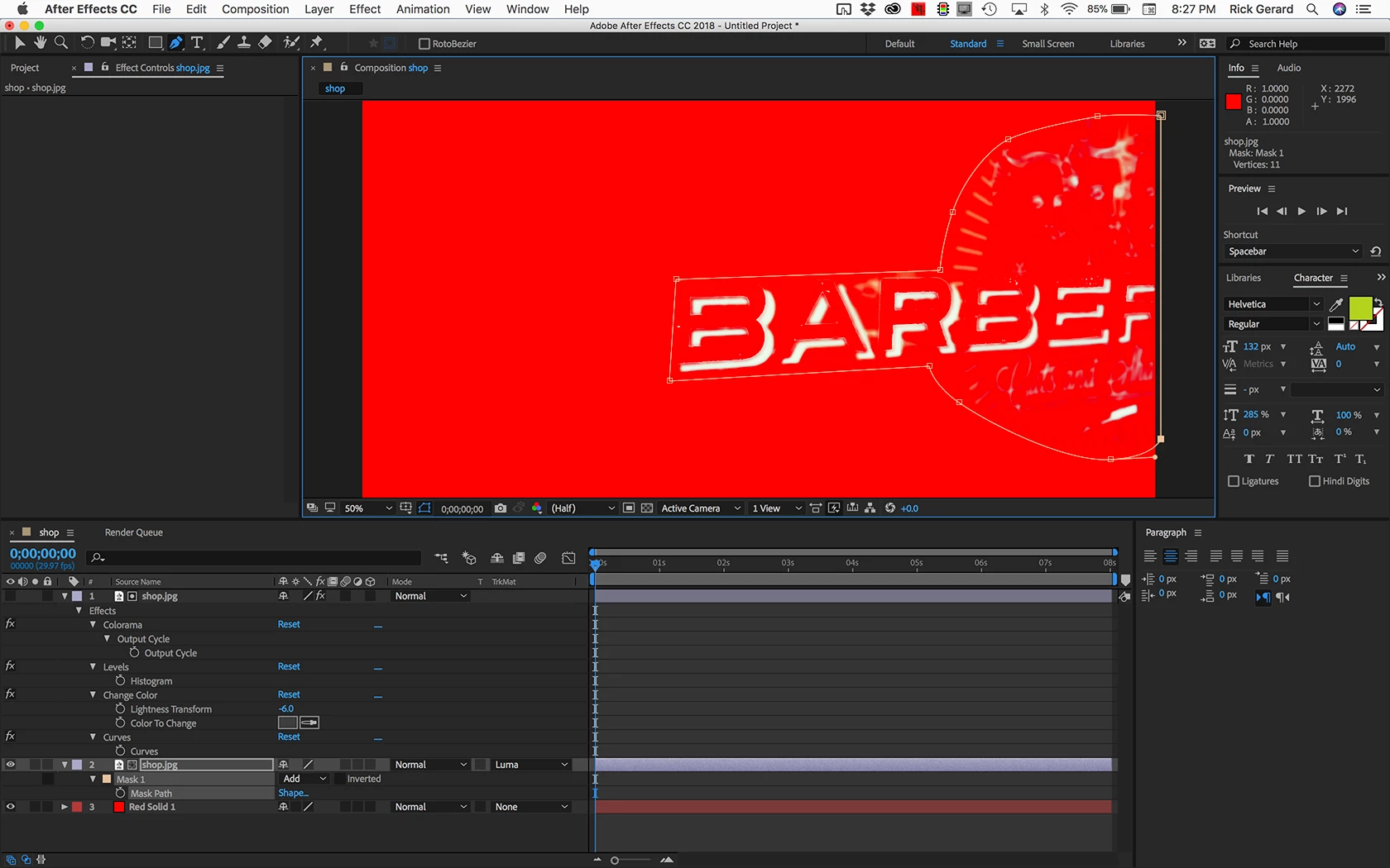

You should also consider trying to create a procedural matte for some of the shot. It looks like the original text layer is white and with a little work I created this comp using colorama, ramp gray, levels, change to color and curves. I stuck a bright red solid below your jpg to you could see how much of the background I was able to remove just using a few effects and a luma track matte.
A little additional work with some loose garbage mattes and a little fine tuning, especially if I had the original footage to work with, may create a good enough matte to remove the entire background from the shot and leave only the logo on the window.
If I saw the entire shot I could give you much better advice. Also, cropped screenshots, like the one you provided, are almost completely useless for diagnosing problems. We need to see the entire timeline with the modified properties of the layers giving you problems revealed. Just select the layers and PrintScreen then paste or take a screenshot and drag it to the forum.
I hope some of this makes sense. You started out on the wrong foot watching a really amateur tutorial and following some genuinely bad advice. Show me the clean shot, describe the camera movement and I can point you in the right direction.
