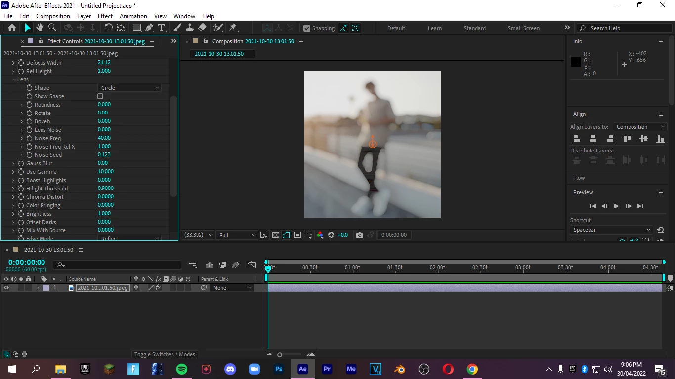

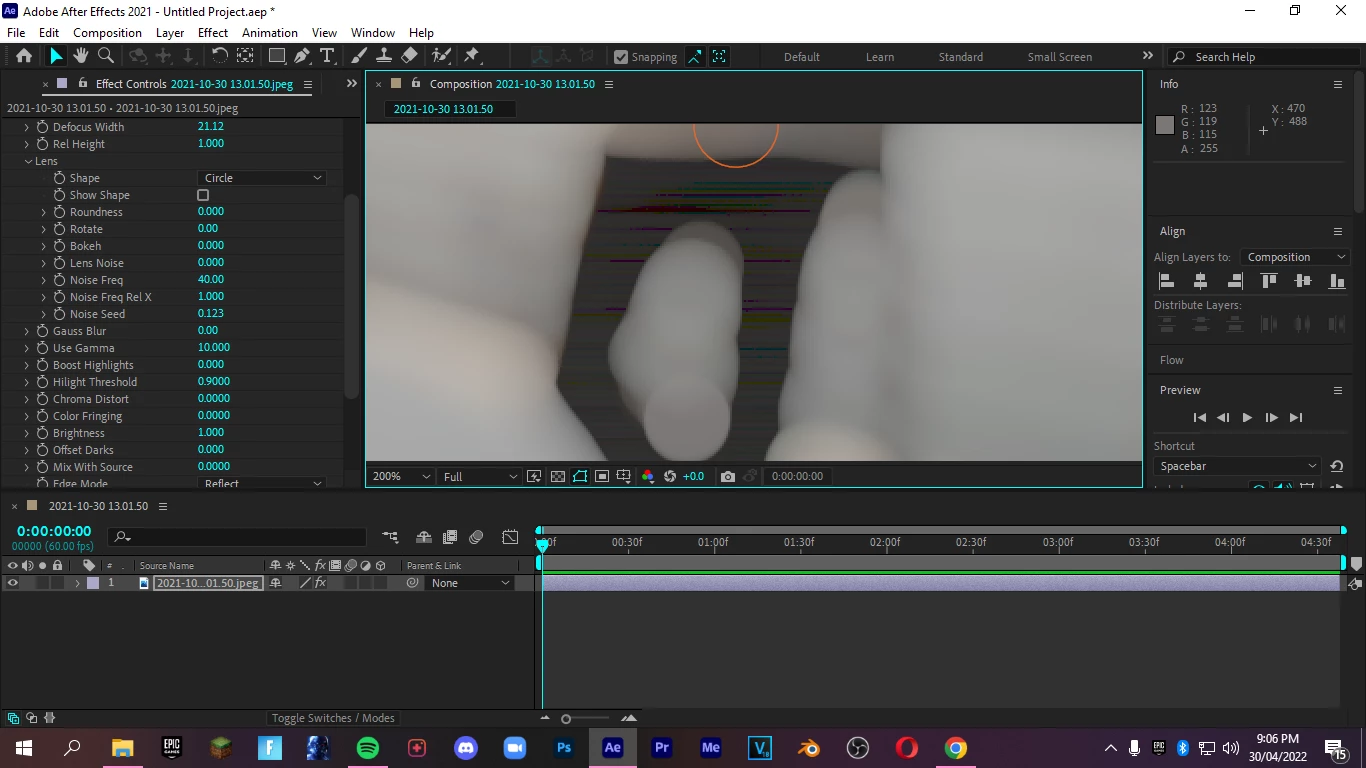

Hey! So when i use S_RackDefocus and turn up the use gamma, it makes the clips have some weird looking and glitchy scan line stuff. Here's some screenshots.
Adding the effect:
Turning up the Use Gamma:
Close look:
I've tried this effect on many clips and i still get this glitch. I've also tried reinstalling BorisFX Sapphire, but also didnt seem to fix it.

The forum won't load the large versions of your screenshots for some reason, so it's hard to see what#s going on, but with Sapphire this typically is either a hardware acceleration problem or a bit depth issue. At the least switch the project bit depth to 16 bpc or 32 bpc. Updating your system's graphics driver may also help. You can also of course simply disable GPU usage in Sapphire and see if it makes a difference.
