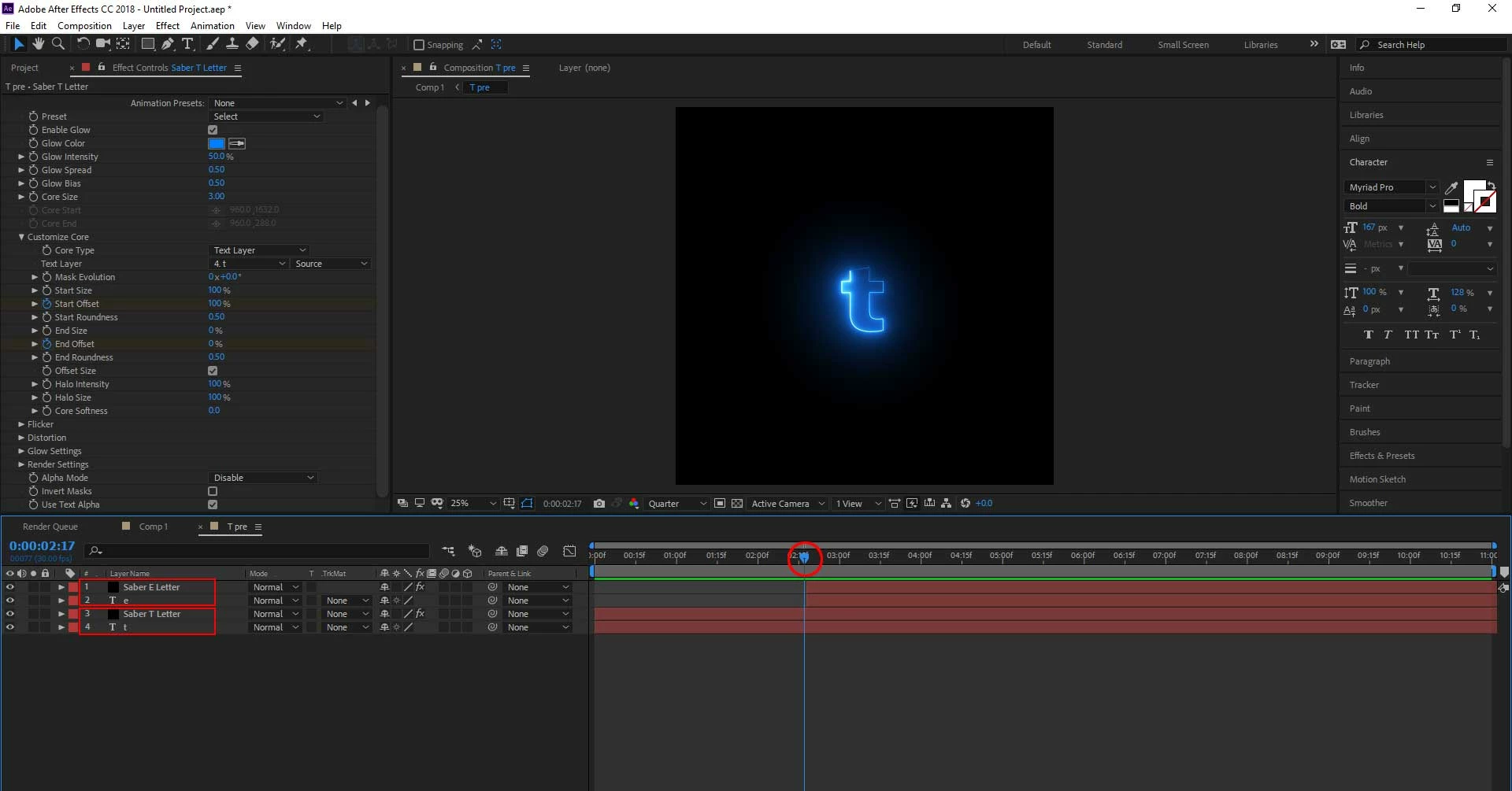

    my apologies Damien, I manged to figure out how to stroke an individual letter using the start Offset and End Offset settings. Im trying to figure out, how to put each letter on a solid layer which dont interfere with each new letter which gets stroked.

    Hi Guys, thanks for the replies
    Damien, I tried the start offset -End offset, altering the amount % on each factor but I cannot get it happening.
    Szalems proposal seems to work better, but I bumped into an issue. Saber works with solids, ( also tried adjustment layer) And its getting covered by the text above it. And Saber needs to work having its layer above the text...
    The AEs Sequence layers command doesn't work, because it makes each letter appear and then disappear as the next letters comes into effect.
