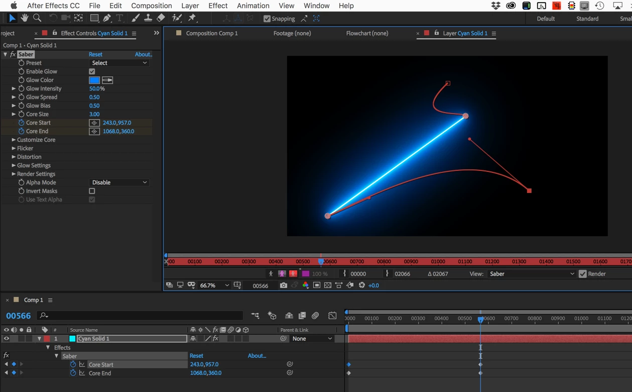

I've been using the new free Saber After Effects plugin for a couple of weeks now and it's great, but out of no where while editing with it, I go to the next clip to use it and the red circles that mark the stop and start of the blade are gone. I don't have a way to click and drag the start and stop points for the blade on each frame now. I went back to look at scenes I'd completed earlier in the project and the red circles had disappeared from those points too but they're still in the correct place. I didn't click and "on/off" button, I just went to the next frame and they went away.
Here's a link to a photo of my project in the timeline: https://i.imgur.com/XWR6k6u.jpg

As David said, you probably turned off layer controls. Clicking on the start or end point tool in the ECP (Effects Control Panel) should give you crosshairs. They are almost as useful as the targets.

Check the view options or use the keyboard shortcut Shift + Ctrl/Cmnd + h to turn them back on and think about my suggestions.

Did you hide your layer controls? You can show and hide them with the keyboard shortcut Ctrl+Shift+H or the menu command View>Show Layer Controls

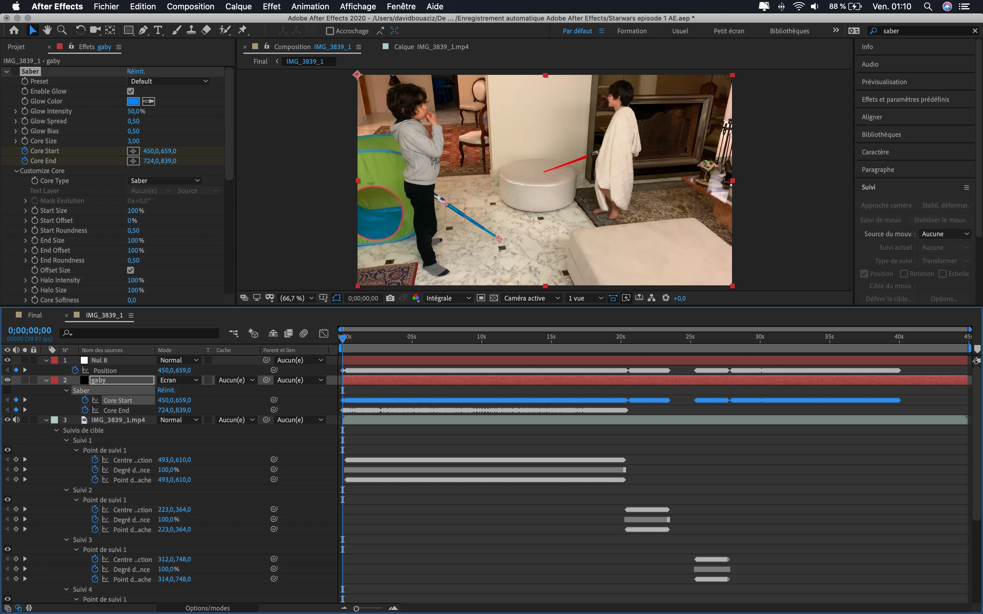

I think using the rotoscoping as a path for the saber is genius but I don't figure out how to proceed can you explain?
the only tool I have are the small target that you move at each frame and if I click on the rotoscope tool then he creates a mask and doesn't put keyframe in the corestart or coreend 😕😕
thanks for your help
