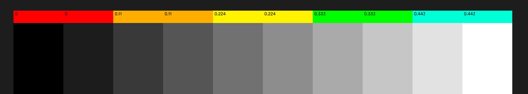

I am trying to control the opacity of layers using the luma value of sample from beneath it in another comp, but it's not capturing the full spectrum from 0 (Black) to 1 (White).
My setup looks like this:
Main Comp - COIN_STYLE_DITHER
Control Comp - COIN (Contains a 10 step gradient from black to white)

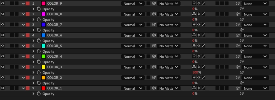

40 x TILE_X Comps distributed across X, each with 10 x COLOR layers ('COLOR_X') that should turn on and off depending on what luma value is sampled from beneath it in the main comp.
My issue is it's combining steps of the gradient and only mapping from 0 - 0.443 Brightness.
I want every gradient band to a new colour appear over it so that 10 Colour layers map to 10 gradient bands.
I know sampleimage isn't supposed to be used in this way but I thought it would work, any help would be appreciated!

I've tried out your project and I can see the logic, but it feels very complicated.  I tried a different method regarding where I planned to set the colour of the solid via a fill effect and an array of colours.  It means significantly fewer expressions running too.
One issue I ran into is that you have 9 colours, but 10 bands of grey.
