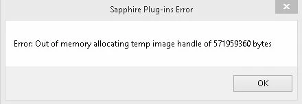

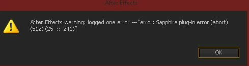

i was supposed to render my project it was half way done then an error popped up
then another one popped up
it also crashed because of the effect "S_Tilescramble"
SigmaNess34830006p8v7Correct answer

Im facing the same issue ,and i also have motion tile with over 400 hundres pixels .
I decreased it back to 400 and i i'll see if it fix that.

I've been trying to figure this problem out for a couple days now and just found the solution. I had Motion Tile on one of the clips that exceeded 400 pixels of length. I changed both the width and height to be 200 pixels and it finally let me render it
