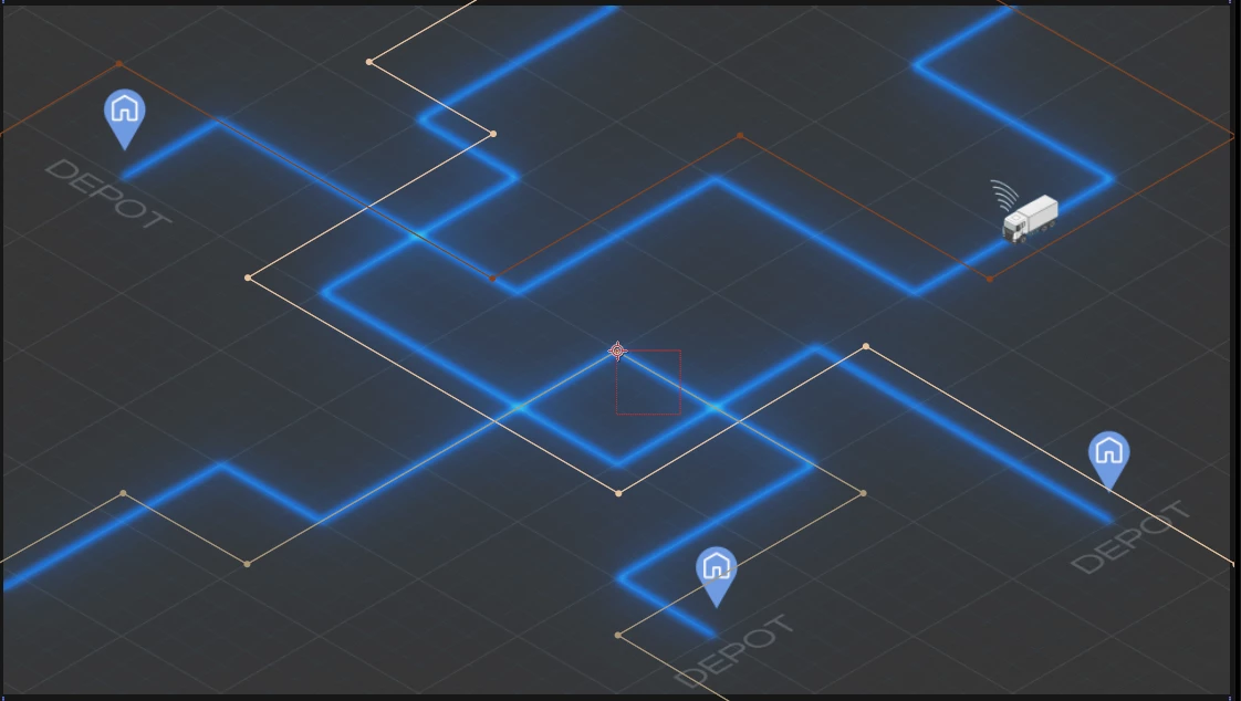

I'm working in After Effects using the Saber effect on a solid that has mask paths. My issue is that when I scale up the mask path, the Saber effect doesn’t automatically scale along with it. I can see the mask growing, but the effect stays at its original size.
Is there a more streamlined way to have the Saber effect automatically follow the mask scaling, or do I need to manually adjust the Saber parameters every time? Any tips or workflows to handle this are much appreciated!

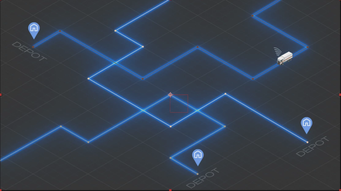

I just tried this: saber on a solid layer.
Both animating the mask path and scaling the layer allowed the saber effect to auto adjust.

Sorry, but I realise that I did not describe the problem properly. I don't try to scale the paths but the Solid where the paths live.
@AidanEdits  sugested to disable the Continuous Rasterization which fixed the problem.
