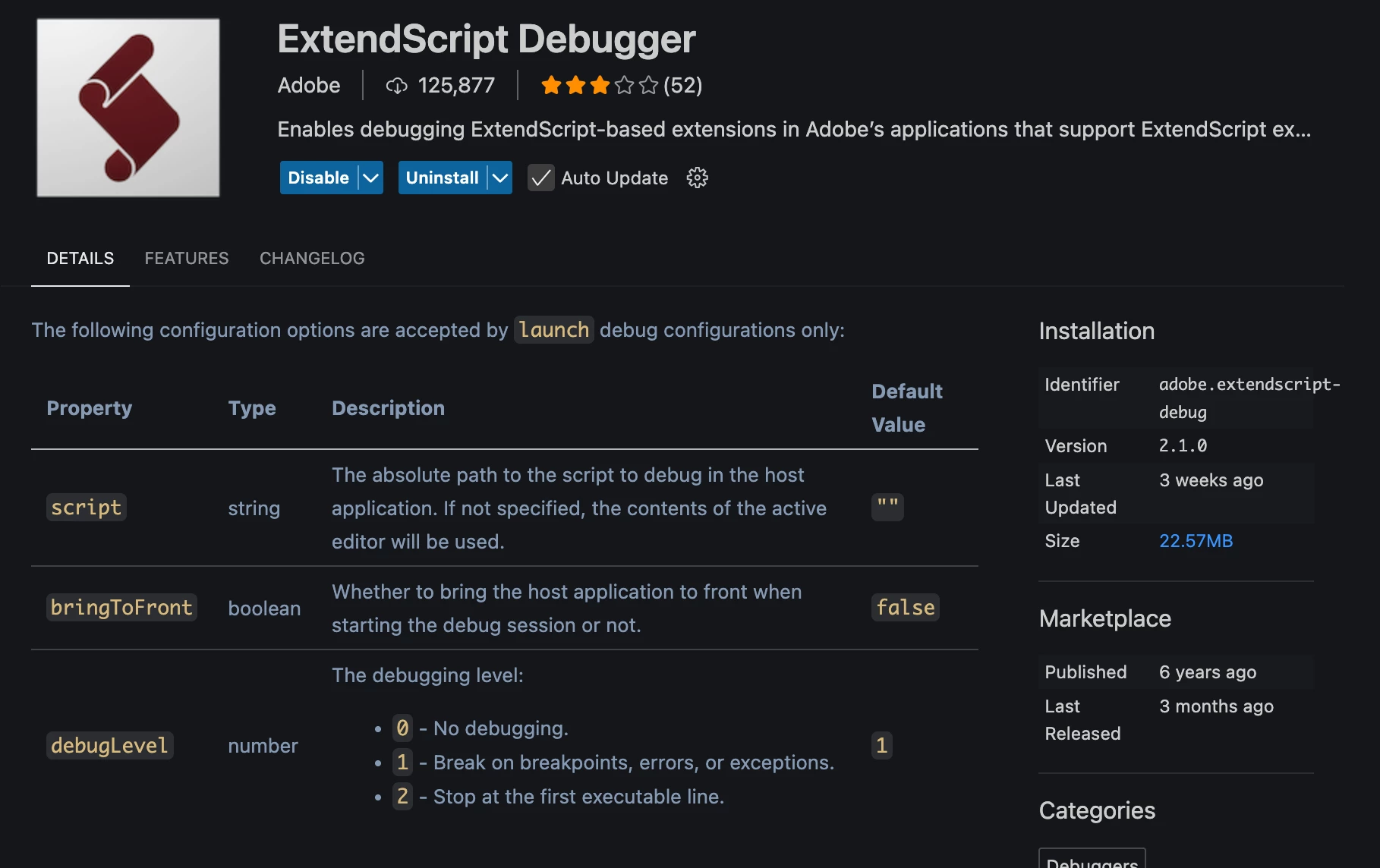

What does your configuration look like in the launch.json file?  You can use a `bringToFront` property and set it to to `true` to bring the host app (and any dialogs from the script) to the front.   You can find more about the the `bringToFront` property in the documentation of the ExtendScript Debugger extension page in VS Code.
See the screenshot for more details, but it basically states that the `bringToFront` property means `Whether to bring the host application to front when starting the debug session or not.`

hey Arie
thanks for the suggestion. I'm pretty sketchy on the VSC config stuff, but I think this is to bring the host app, i.e. after effects to be the 'front' application when running the script. It's also only available in "launch" mode not "attach" which is what I use to get callback debugging (again this may be a misunderstanding on my part on how to set things up properly). But the wierd thing is I have a near identical setup on my PCs and it works fine on them, ScriptUI panels always stay on top, it's only the M1 Macbook that has the issue.
