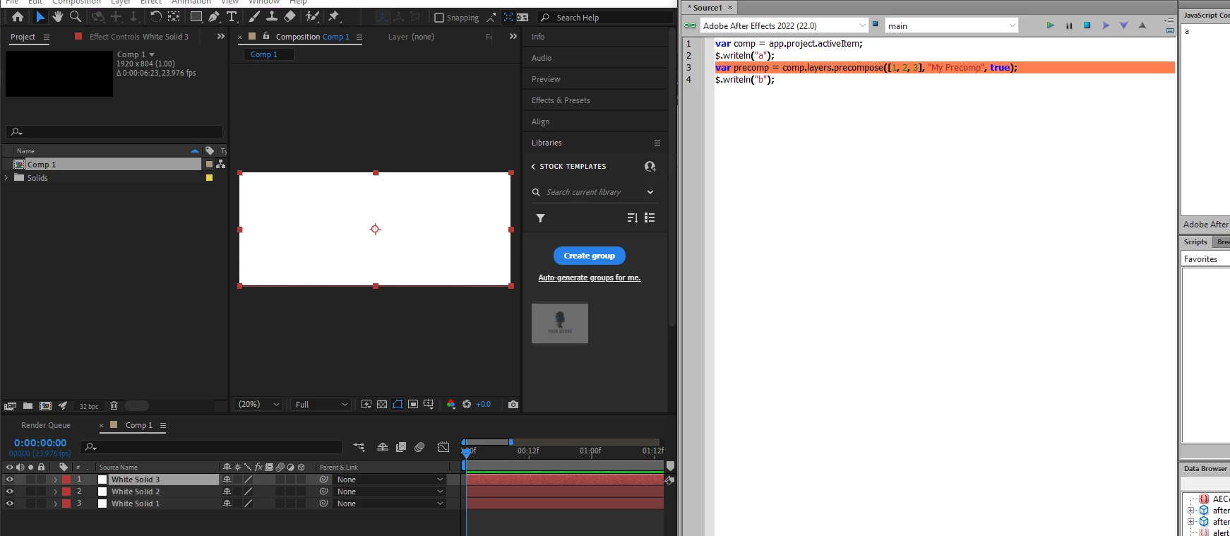

Scripting .precompose() bug in CC 2022
  • February 22, 2022
  • 355 views
AE CC 2022 appears to have an issue with .precompose(). The precompose() method is called and fully executes precomposing and naming, but goes no further. In VSCode this is how it appears to behave, but ExtendScripts reveals an actual error:
The ExtendScript Error Reads:
After Effects Error: bad tracked memory id
I noticed this error in AE v22.1.0, upgraded to 22.2.0, and the problem still persists. Is this just my computer or is this an AE-wide bug that will break all existing scripts that use .precompose()?

Nathan Lovell_52
February 22, 2022
My comp is indeed active. The precompose method is running all the way through, precomposing my layers and naming them what I provide. The error is coming up after processing the method, and stopping the script completely.
