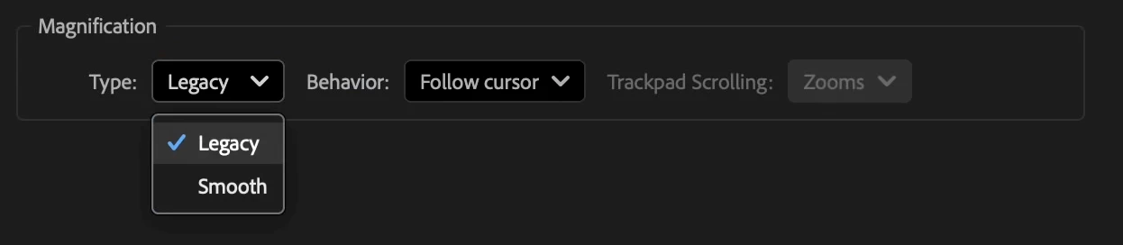

As many have pointed out, changing the Trackpad Scrolling behaviour to ‘Zooms’ adds the mouse wheel scroll-to-zoom function on non-magic mice (like Logitech MX master), but at the cost of loosing the mouse wheel scroll-to-pan. Some users are okay with that.
What worked for me was changing the Type from ‘Smooth’ to ‘Legacy’ in the same section. That enabled me to scroll-to-pan as normal, but then hold the cmd modifier key and scroll-to-zoom, which is the best of both worlds.
Settings/Preferences > Previews > Magnification > Type: Legacy
Not sure if Adobe added this option recently, but it works like it used to now.
JEdits
April 16, 2026
Only drawback I’ve noticed is you loose the smaller zoom increments - you end up with the older large zoom steps as you scroll in and out, but personally it’s worth it for having the handy cmd modifier function back so I can zoom in and out and pan up and down via scroll. And yes, I do also use hold-spacebar to grab-pan around the frame when I need to.
March 26, 2026
If it helps, I never realised you could pan with the scroll wheel until I started using (I think) After Effects 25. Before that my mouse wheel would only zoom in large increments (the same as using ‘<’ and ‘>’ shortcuts), and it wouldn’t zoom in to the position of the mouse; only to the centre of the Comp window.
Version 25 brought with it the ‘new’ zoom which zooms in smaller increments to where the mouse is on the screen, but it’s only version 25.5 or 25.6 which swapped the controls so the mouse wheel would control the pan, hence why I found this post to swap the setting back (which is the first time I’ve seen it in preferences).
The version numbers may not be exact but I think it lines up with other people’s version changes here.
I’ve always just held the space bar to temporarily activate the Hand Tool in order to pan, which has been super handy
