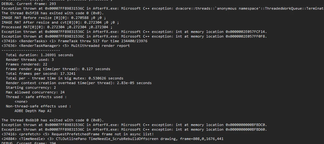

yuriy80149087
June 8, 2023
It's message on this types of frames. I get an exception that I can't handle.
