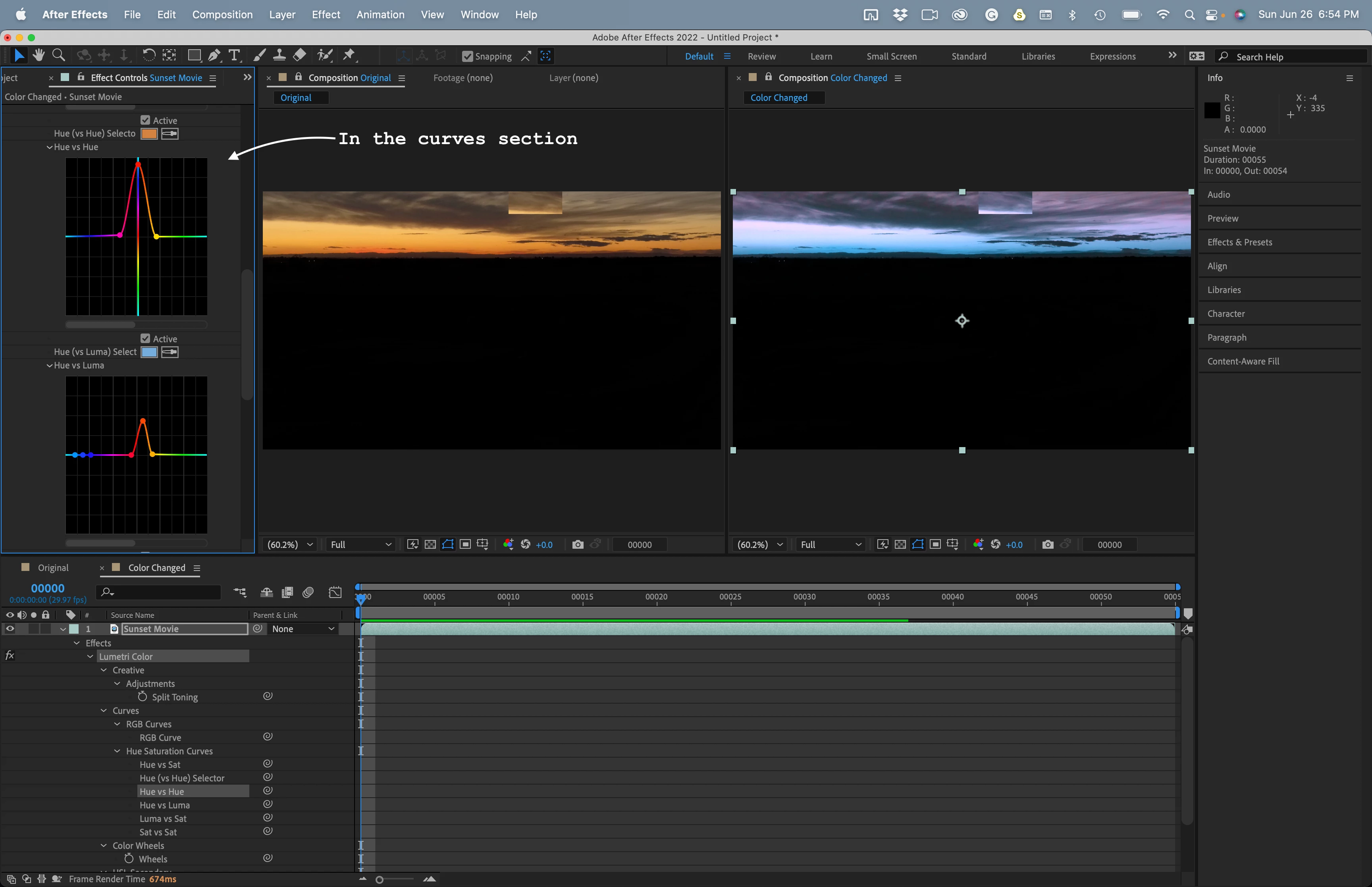

I have an object with orange reflections. If I want to change these to blue reflections, whats the best way?
Correct answer Rolf5E3D
I tried curves but there is no blue in this orange part so its not useful. The ChangeToColor was excellent, just choose the exact color to change and pick the color you want to change to.
June 27, 2022
If you only want to change the color of the reflections, you will need to isolate those colors. That may require a bunch of work, or it could be as simple as adding Lumetri and sampling a color, then sliding things around in hue vs. hue.
It could be that simple or require several hours of Roto work and multiple layers. If we could see a screenshot, we might have some ideas.

Thanx, I saw a tutorial on "change to color"-command and it seems very straightforward. Its a small objekt that is cut out with a mask so there is no risc of changing any colors I dont want to change, all the orange on the object should be blue. I have isolated  objects before with color range key or auto trace much like you suggest but chane to color seems easier in this case. I will make a test and see whats easiest.

You can use any HLS effect (Hue & Saturation, Color Balance (HLS)) and adjust the Hue setting. Or you can use the Curves effect, under the dropdown select "Red" and drag some points.
