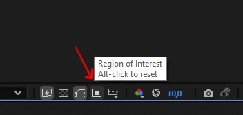

You have activated "region of interest" tool.
