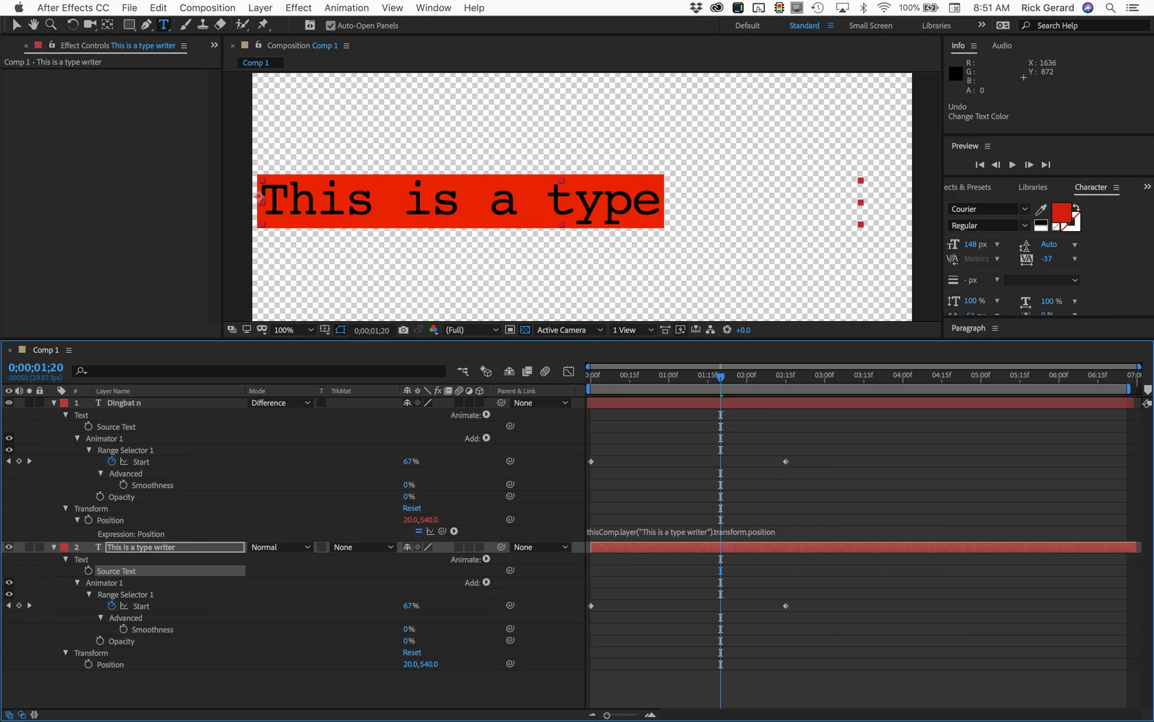

    Right off the top of my head, the easiest option may be to use a monospaced font, apply the typewriter effect, duplicate the text layer, set the blend mode to difference to turn the letters black, change the of the top copy font to a dingbat and change all of the letters to "n" to give you a solid square, adjust the kerning, scale and baseline offset so the square covers the letters, add a stroke and you're done. If both text layers were green the project would look like this:

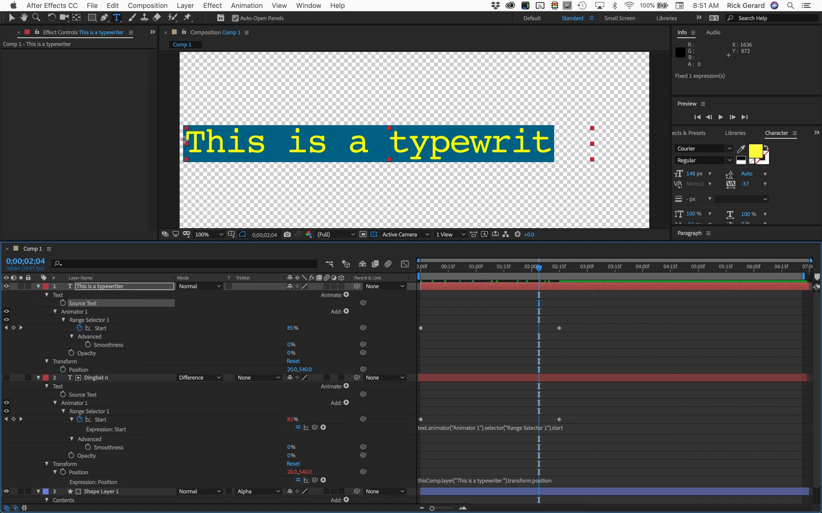

    If you want more control, add a shape layer rectangle bigger than the final text layer below the dingbat layer, set the dingbat layer to a track matte, move the typewriter layer to the top and adjust your colors. You'll get this:

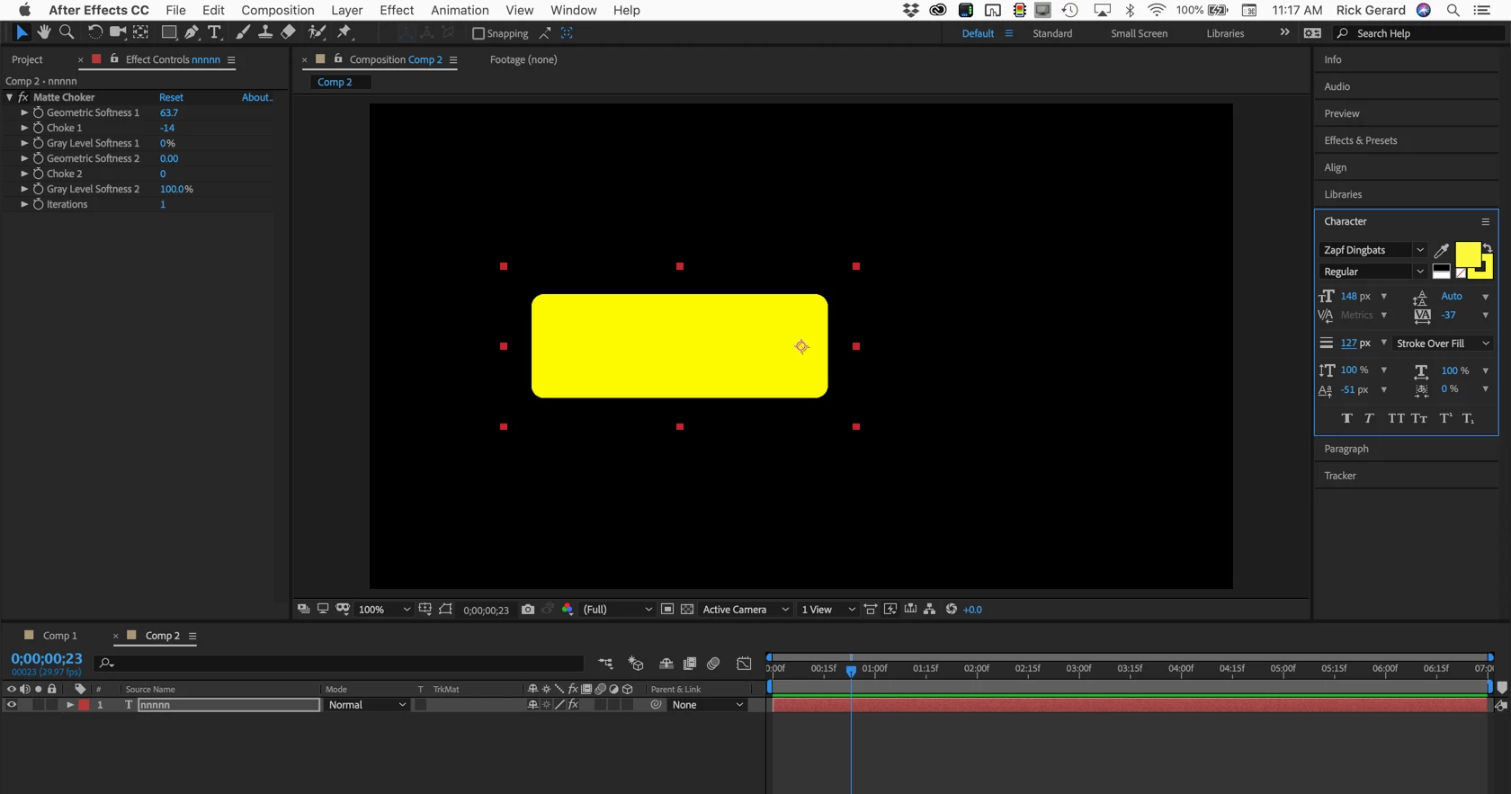

    You would need multiple rounded rectangle shape layers to get multiple lines.
    Personally, I would probably use the duplicate text layer + dingbat track matte solution and add a stroke then add Matte Choker to round the corners. That would work with either solution 1, difference mode, or the track matte solution I posted above. This is a bunch of N's with the matte choker applied:
