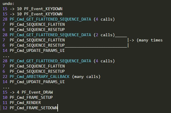

here is an order of called events after ctr-z:
Many seq calss, I have all of them (accordingly with that doc:
https://reduxfx.com/ae_seqdata), but its not working for me.

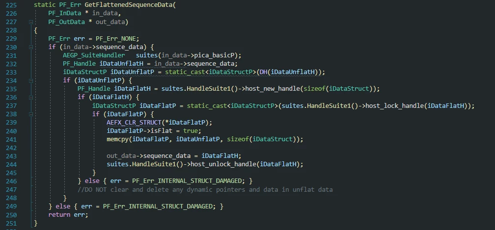

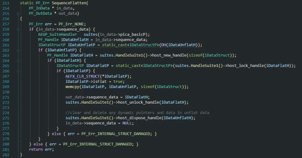

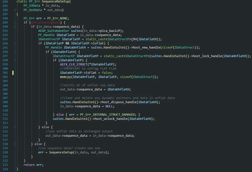

Maybe problem in my seq flattening functions..
If it helps:
