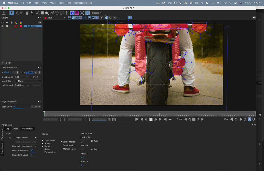

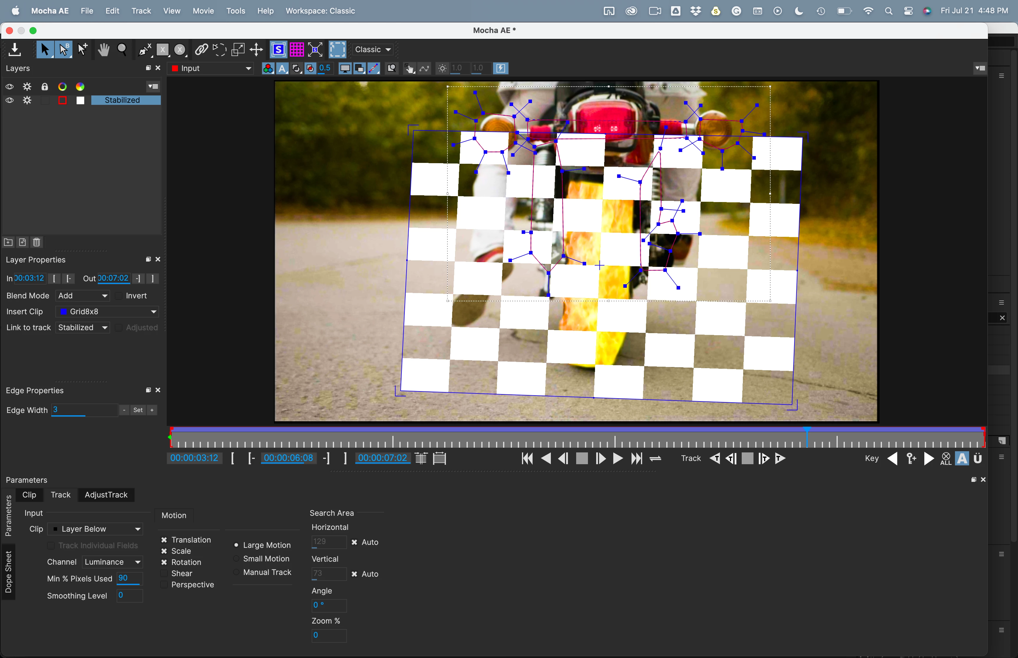

The shot has enough details to use Mocha AE to track Transform (position), Scale, and Rotation. You will need to apply some serious color correction to the shot to give yourself enough detail to track, then pre-compose before running Mocha AE. When tracking is complete, Create a large Surface like this:
Then you can apply what I call the Stabilized Power Pin workflow to a duplicate of the original footage, pre-compose, then create your replacement tire effect on a motion-stabilized version of the shot. Throw in a little Camera Lens Blur to match the depth of field and work with some other effects to make the fire believable, then return to the Main comp and apply Corner Pin to your tire replacement layer, and you should have it.
Here is the workflow I would use to complete your shot:
I uploaded a Project file that uses your Set Tire on Fire 2.mp4 footage and replaced the tire. It should geet you started.

Take a look at the comp I uploaded and check the tutorials. The shot is plenty doable, you just need some stock footage and some masking, and a comp similar to the project I uploaded.
The biggest trick to making it believable is going to be the color correction and adding glow and blur layers to make it look like the fire is casting light on the Motorcycle. It would probably take me a day or two to make the shot completely believable with Smoke, fire, and illumination layers. All of those effects would be added in a Corner Pined/Power Pined pre-comp.
The easiest part of the whole project would be creating the Tracking data in Mocha AE.
I'm working on a tutorial series for Mocha AE that will be released soon. I had not thought about a similar shot, but it would be a good addition to the series.
