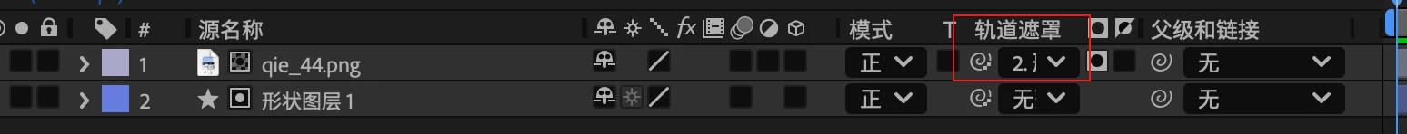

Hi,track masking requires two layers (the mask layer and the masked layer).Cannot set mask if there is only one layer
hold on... a track ammte and a mask are two different things...
1. track matte - one layer operating with the alpha/luma of the layer above it.
2. mask - a vector shape drawn on a layer with the pen tool.
if your situation is the same as #1, then the mask suite is the wrong way to go as there are no masks on that layer, and then getting 0 as the num_masks actually makes sense...

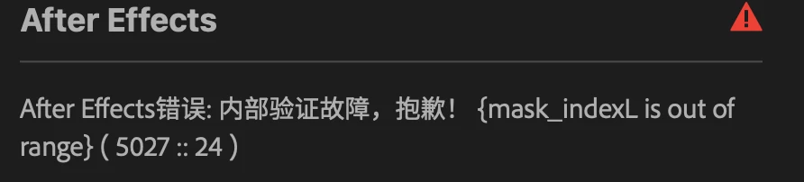

If I do not check the number of masks and directly call AEGP_GetLayerMaskByIndex to get the mask with index 0, AE will report the following error
The above error message indicates that the current layer does not have an exportable mask.
But the mask has indeed been set in AEtThe following is the corresponding project file
Yes,My situation is the same as #1.
Which API should be used to export the track mask? Is there any sample code that I can refer to?
