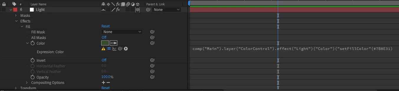

Hi, I'm having trouble changing the colour of a light layer in a logo reveal template.
When I change the  colour from red to green it keeps defaulting to red.
I think it is to do with the expression which is comp("Main").layer("ColorControl").effect("Light")("Color").
I've tried various commands such as comp("Main").layer("ColorControl").effect("Light")("Color")("fillColor#7B8E31")  and "ColorControl#7B8E31")  but keep getting error warnings.
Could someone help? Thanks very much!

Jun 21, 2024 11:14 AM UTC
should be enough, try to check the name of the composition, the layer name and the effect name in the expression, there might be an issue with capital letters.

Jun 23, 2024 7:45 AM UTC
thanks very mcuh - tried this but since been told that apparently it had to be altred on another layer and not in the same expression,

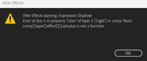

Jun 21, 2024 9:10 AM UTC
thanks- tried this but unfortunately still getting an error- see attached

Ben5FBEAuthor
Jun 21, 2024 9:01 AM UTC
Tried this but still getting an error unfortunately.
full script looked liked this: comp("Main").layer("ColorControl").effect("Light")("Color").setValue(hexToRgb("#7B8E31")
also tried with the 2 brackets.
