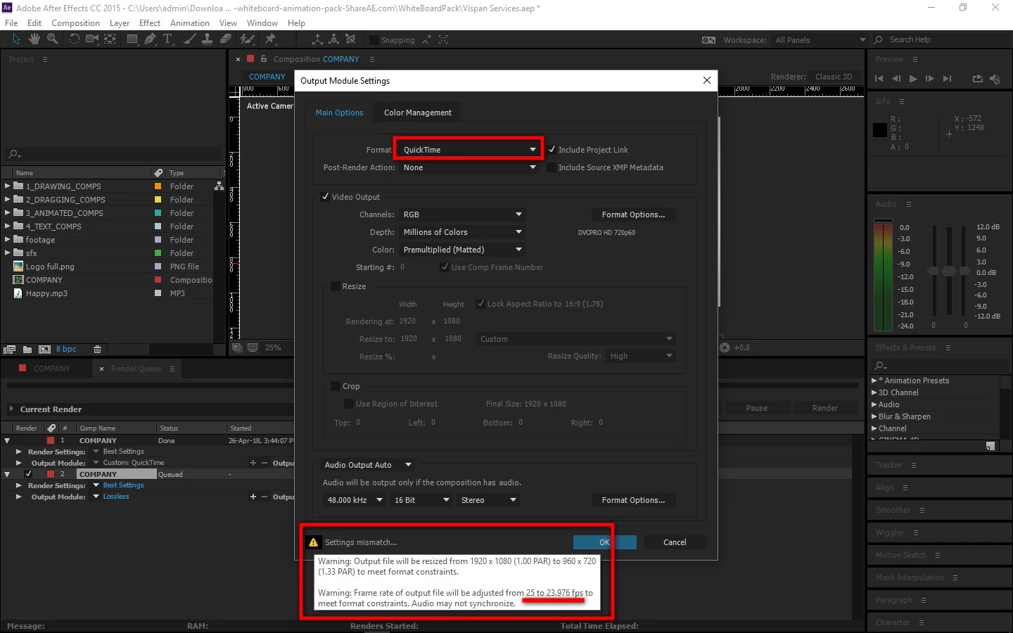

I was facing an almost similar issue.
After rendering sound was not in proper sync. & I have made FPS of composition and GOT SUCCESS !!
1.  Just note "25 to 23.976 fps"
2.  Go to Composition menu > Composition Settings > Change 25 to 23.976 > Click OK
3.  Again Rander the Composition with same settings with QuickTime.
4. Success
This solution works for me. It might possible that you might need some other fix.
If it works for you as well then Give me CHEERS !!
Thanks.

It means what it says - you have to did into the MPEG-4/ H.264 encoder settings ont the Output Module's "Option" panel. Presumably you are simply using a wrong default preset or an odd comp size and the encoder can't make up its mind.
