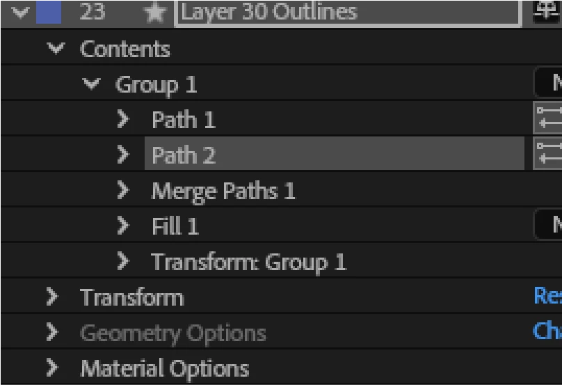

Mar 5, 2025 1:57 PM UTC
this was caused by an extra path in the layer, in my case.
Select the layer;
go to Contents > Group 1 and check if there is an extra path taking the whole screen, then delete it.
