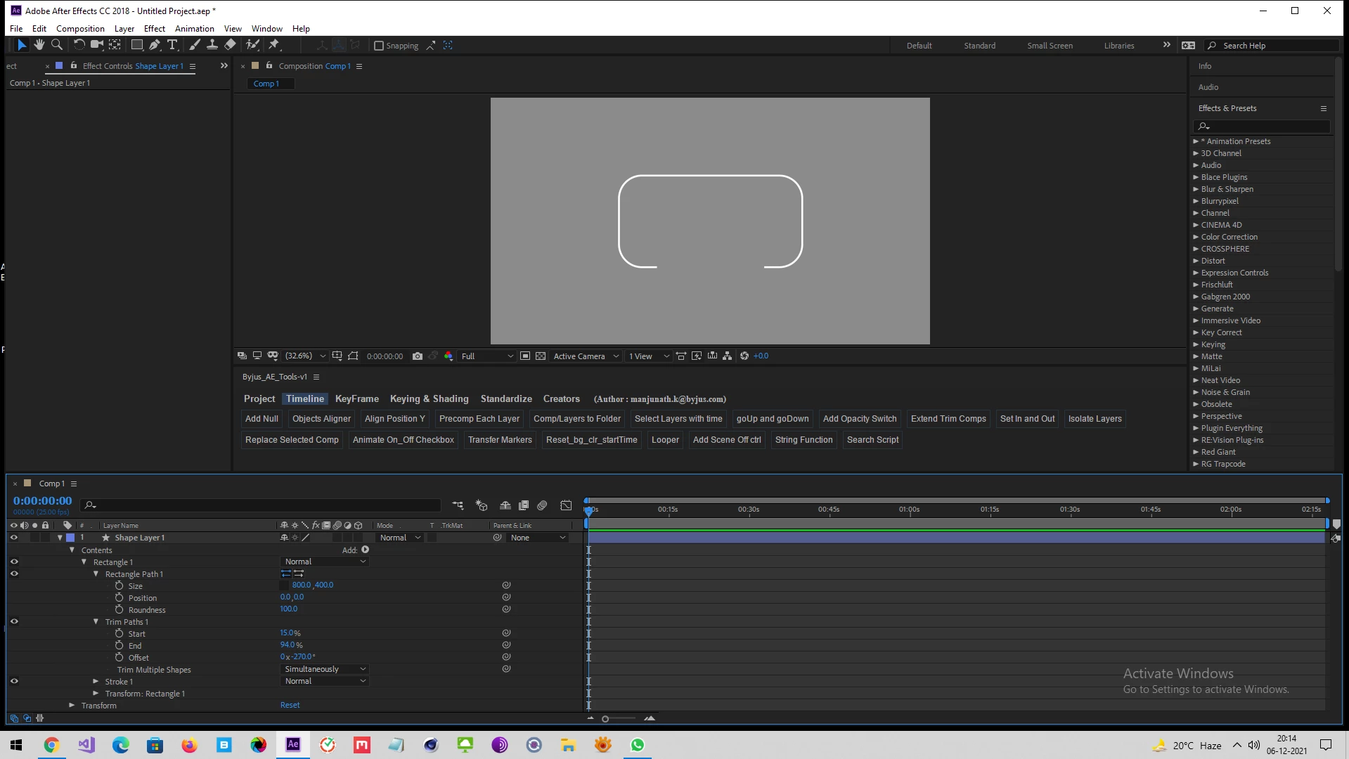

I understtod what ur saying. Attached is the exact trim shape to retain, even if size [x,y] of rectangle changes.
No need to touch offset.I ll make an edit to this question. just start and end of trim path
@Rick Gerard @Mylenium to keep things realistic, i have attached an exact shape to work for. Also, given the same to @Dan Ebberts as well. Thank you all, Math wizards.

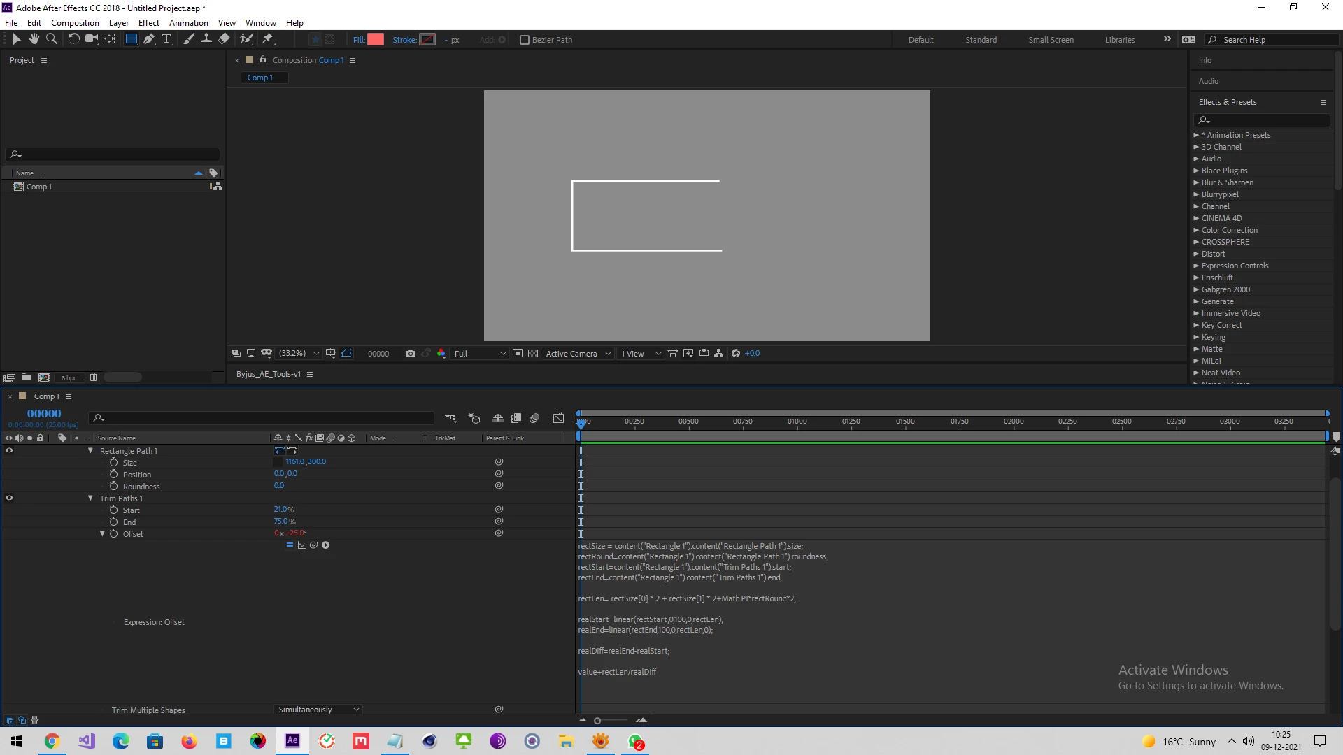

Is  this code tested. its not working for me bro.attached is a screen shot.
also i have attached my version of code which works for trim end with known issues.
it seems like not working when end slider is at 1750.(right edge)
At slider 1585, when end goes to bottom edge, there size x maintains distance in relation to bottom left point, but y doesn't work.
like wise in differrent locations it behaves differently but it works perfect at slider -183.
Plz check if it helps and help me with custom start,end with rectangle size.

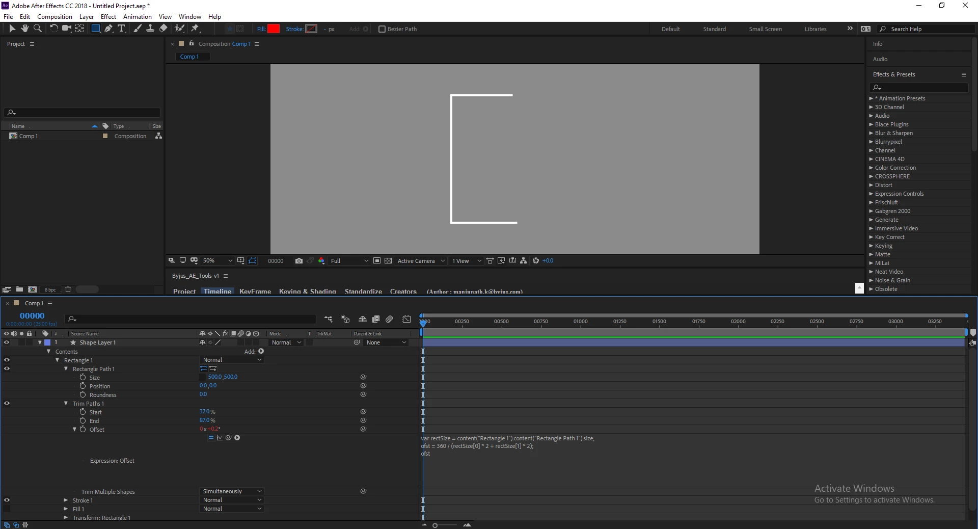

Hi rick,
Thank u for ur reply.
I tried below expression and i found its not working wihtout roundness as well.Attached is screen shot for ur reference.
var rectSize = content("Rectangle 1").content("Rectangle Path 1).size;
ofst = 360 / (rectSize[0] * 2 + rectSize[1] * 2);
value + ofst
Trim paths is like nighmare for me while standardizing AE templates with expressions. Hope it ll get sorted.
