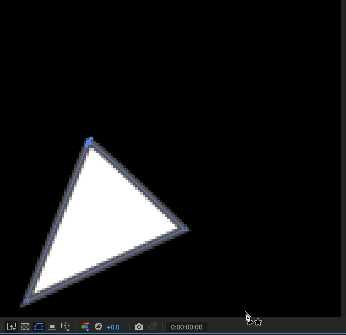

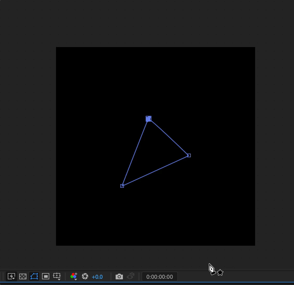

I made a shape, and applied fill property but it doesn't appear when I zoomed out little bit.
Zoom in, then appear again. It repeat again and again.

This is the situation of zoom-in,
  This is the situation of zoom-out.

Without any info about your system, your comp settings and so on we can't really tell you much. Based on your screenshots, however, the pertinent conclusion would have to be that you are trying to create very small artwork. Even the zoomed out comp looks like it's only 200 pixels or so. That being the case, the most likely explanation is that this messes with hardware acceleration. In this case only turning of hardware acceleration may allow you to work, so check these things. Anything more will require specific information.
