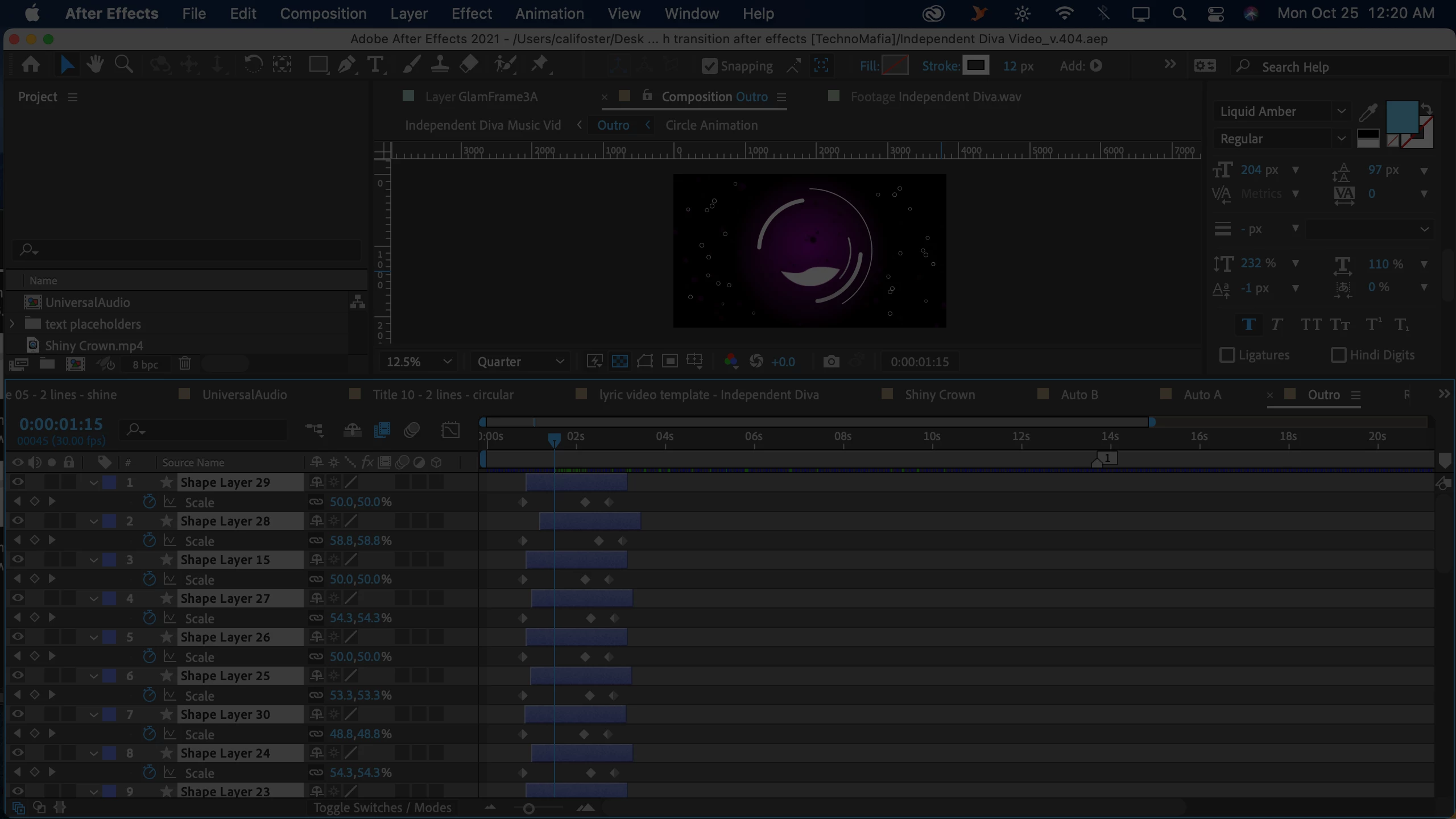

Hello, I have tried everything to get these sprites I made from 30 ellipses to appear within the entire project. The appear when previewed within one of my comps, but not the whole comp...even when I dragged them all out.
What should I do?
Thank you very much!

Hi One&Done,
Thanks for reaching out.
A screenshot of the parant comp with the modified properties visible (select the layer and press "U" two times in a row) would be helpful to understand what's going on.

The only thing is that I did make it in another project completely. Then I imported this. This made me realize that the comp sizes were different.
Get this, it was all a matter of scaling down abit, as my sprites were around a bit larger version of my animated logo. Pressed 's', scaled it down some, and Voila!
Thank you two for literally helping me to think outside of the box!

Any chance you've turned them into guide layers in the parent comps? Other than that there is nothing particular discernible in your screenshot that should cause such a behavior.
