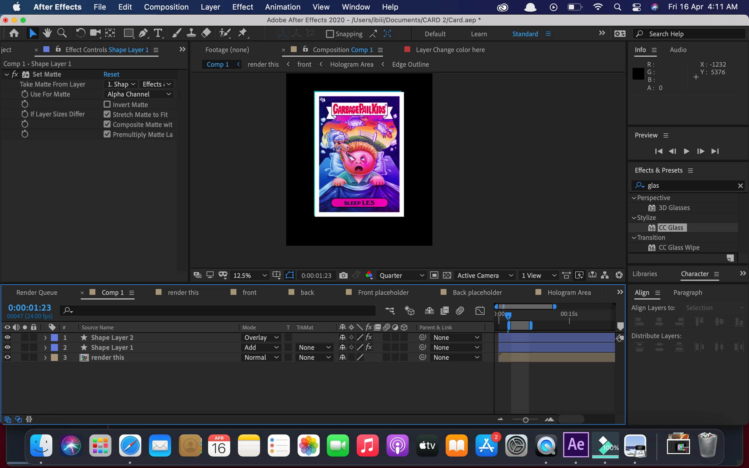

I don't see the modes column and it does not look like you are using the Add or Screen blend mode anywhere in your comp.
Turn on both of the first two icons at the bottom left corner of the timeline panel so we can see both the switches and modes column for your layers then drag the screenshot to the reply field and not the Drag and Drop here area so we can see what you have done.

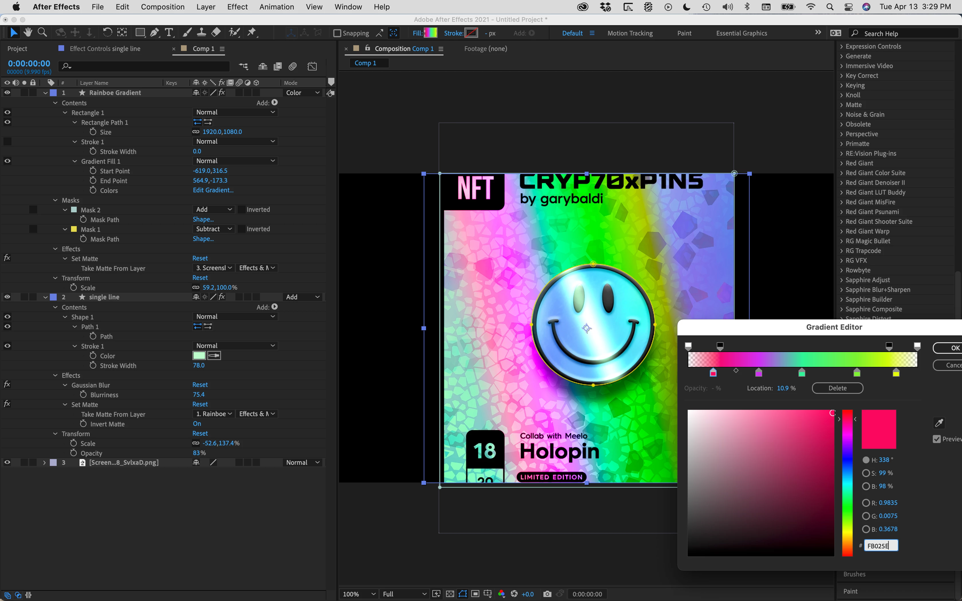

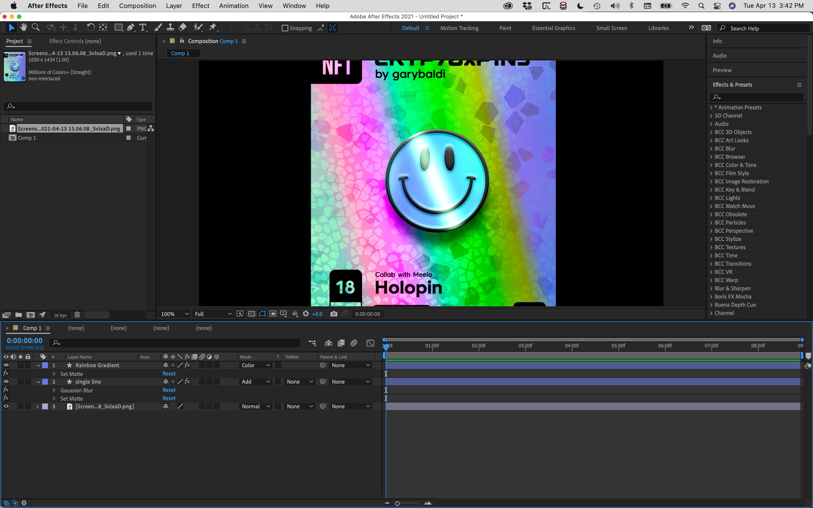

To fake it:
I'd start with a shape layer gradient with opacity on each end and add a single line stroke with gaussian blur, then fiddle with some blend modes and animate everything. Starting with a screenshot of the effect without reflections this took a couple of minutes.
