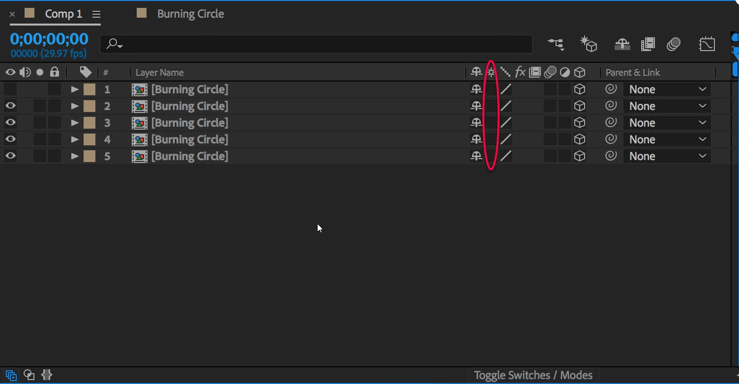

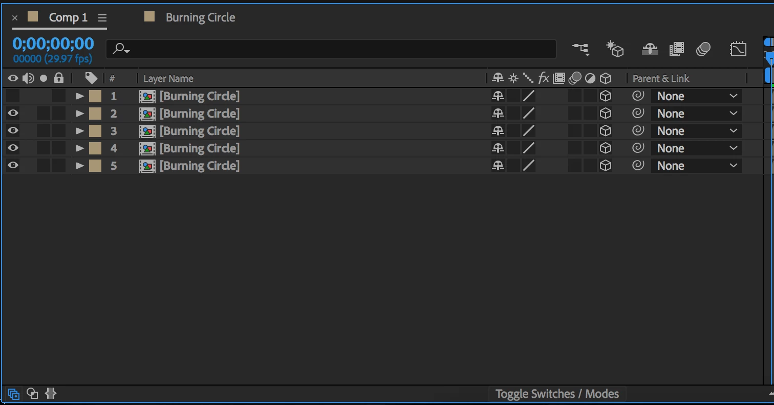

    Sorry about that, let me turn on switches and modes. I was hoping to not have to make the layers bigger than they currently are, any way to work around that? Thanks for the help. Is this what you needed in the picture for switches and modes?
    imeilfx
    May 13, 2018
    As Rick said. Your glow light goes beyond the layer borders. Try to turn on collapse transformation for all of your layers (that "sunn" icon
    if that will not help - expanding layers size will be the only thing that will fix your animation.
