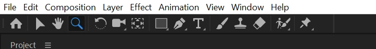

    Oct 22, 2019 3:31 PM UTC
    I desperately needed this functionality, also, and finally found it. I need to zoom in for precise placement of masks, etc. but not affect the output zoom level of the display.
    What to do:
    In the toolbar just above the Project Panel, select the Zoom tool. In the Composition Panel you can click and drag to define a rectangle area that you wish to zoom in on and, when releasing the mouse button, the view will zoom to the area you selected. After zooming, use the Hand Tool to reposition the area in view as needed. To return to a standard zoom level, use the magnification dropdown list in the lower left of the Composition Panel to select "Fit" or any of the standard zoom levels.
