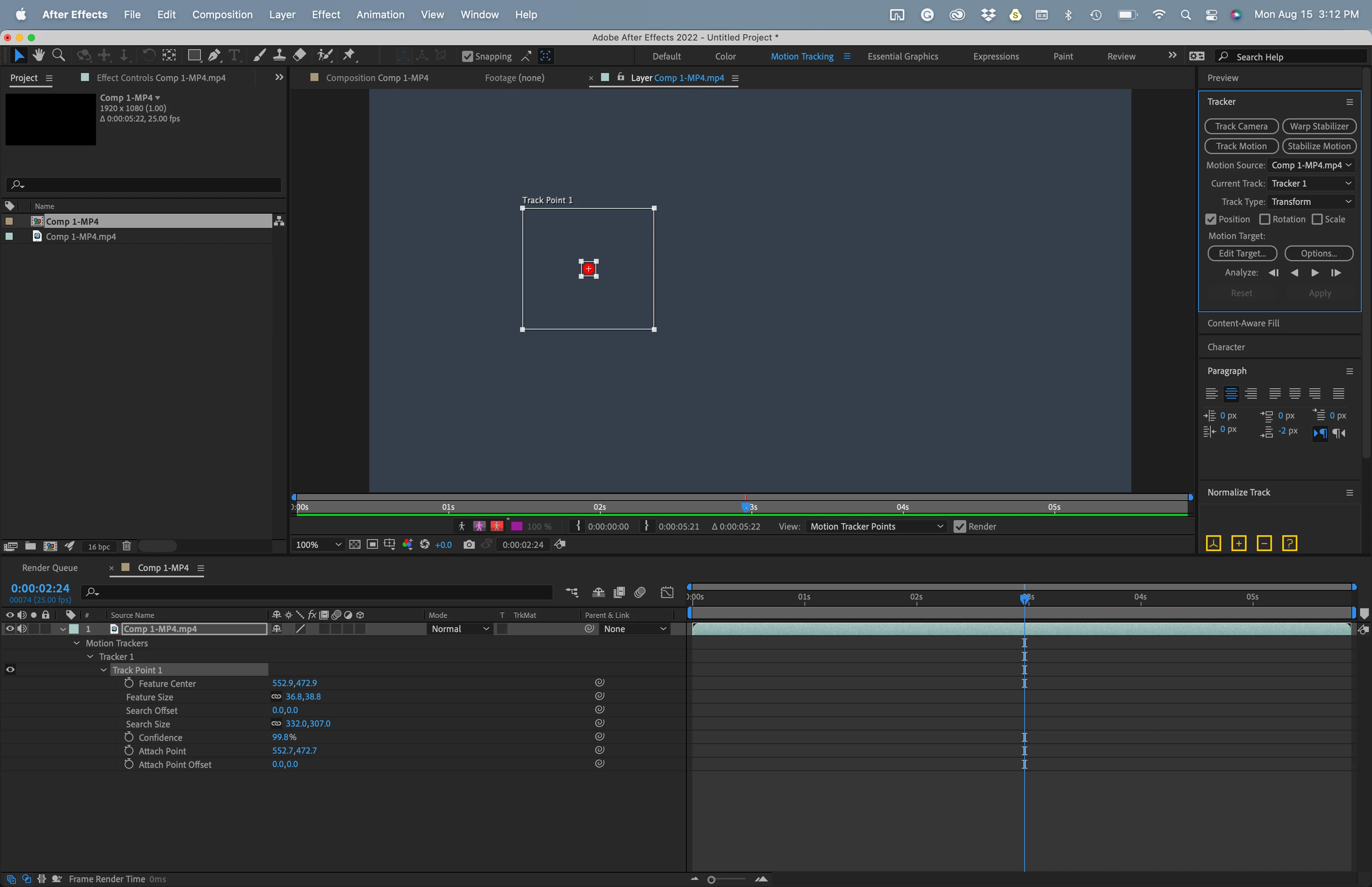

Trying to make a very simple red dot tracking in After effect 22.5.0 Build 53, but the tracker doesn't follow the point at all, even though it looks super simple to do. ?
I made a video to show what i'm doing: simple transform tracking , 2D,
Any advice ?

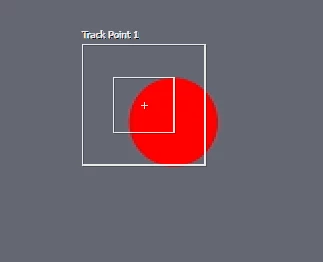

The feature tracker, not it's not a point tracker, has a feature region, the inner box, and a search area, the outer box. The search area must be big enough to find the detail area in the next and previous frame. The Feature must have some detail. A fairly large red dot against a gray background does not have much detail. Your feature region should include the dot and about the same amount of background. The search area should be a fair bit bigger than the maximum movement of the dot.  I got a near-perfect track with this setup:
The project file is included. Understanding how the Feature tracker works helps you figure out which shots it will work on. This is one of the few shots where Feature Tracking work better than Planer tracking in Mocha AE.

Check the "Options" button in the tracker panel. By default AE tracks luminance, not color and your grey and the red dot have pretty much the same values or at least not enough contrast.

The tracker works by following a point of pixel contrast  (or something like that).
Instead of putting the entire dot inside the tracker view,
try moving it over an edge of the dot so there is both red and grey.
