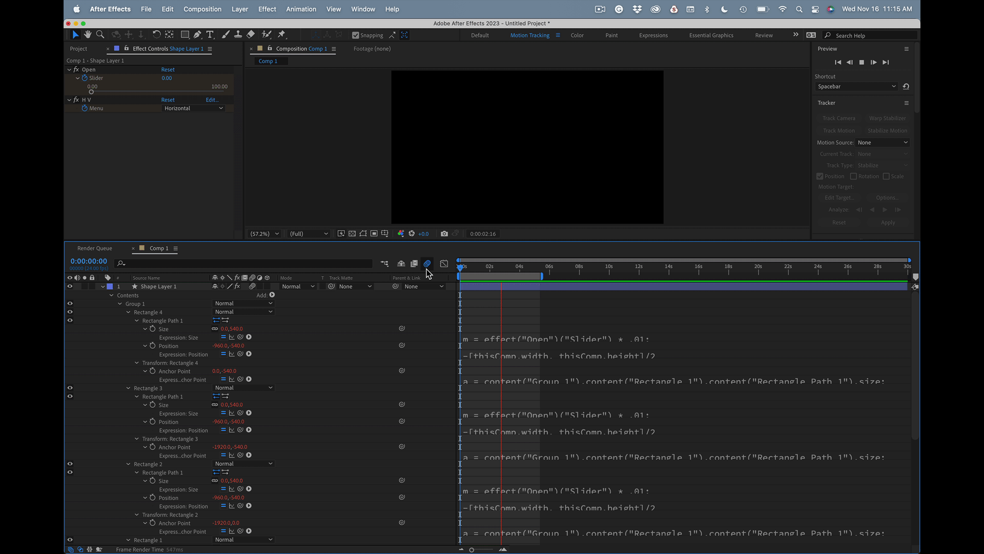

    You could do the whole thing with one shape layer, a few expressions, and some expression control sliders. Check this out:
    Here's the animation preset. Just apply it with no layer selected.
    I already had it and just gave it a few tweaks to update it.
