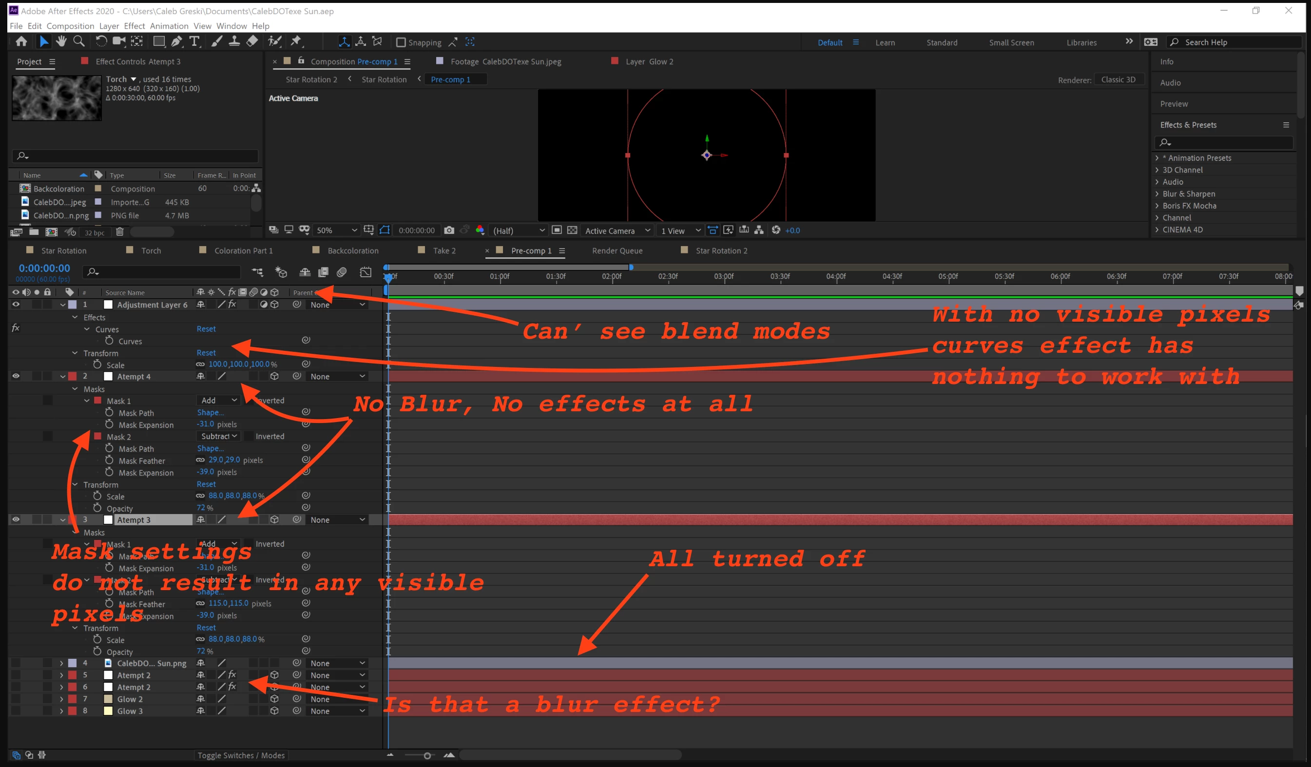

You didn't add your screenshot using the toolbar to embed it in the post so I had to download it and I see a lot of problems:

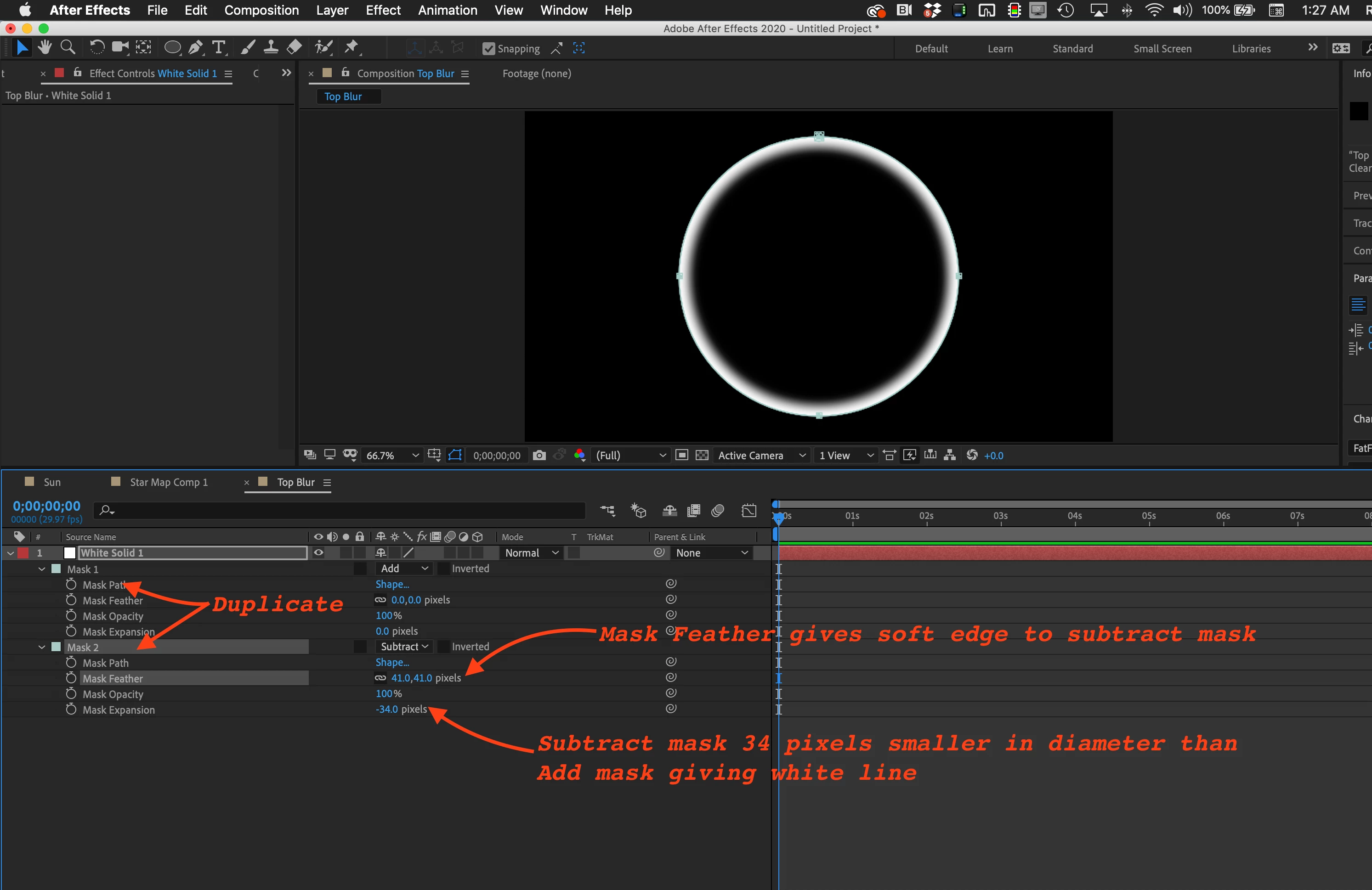

The biggest problems start with duplicating the mask, setting the bottom copy to subtract, and then making it smaller to reveal a white ring, then adjusting the subtraction mask's feather property to give the inside of the ring a soft edge. Start by fixing the problem by clicking the solo switch to isolate the layer, press m m to reveal all mask properties, delete mask 2, press Ctrl/Cmnd + D to duplicate Mask 1, set the bottom mask to subtract, if you need to press mm again to reveal all mask properties and reduce mask expansion enough so you can see a prominent white circle, then adjust the subtraction mask feather to soften the inside edge.

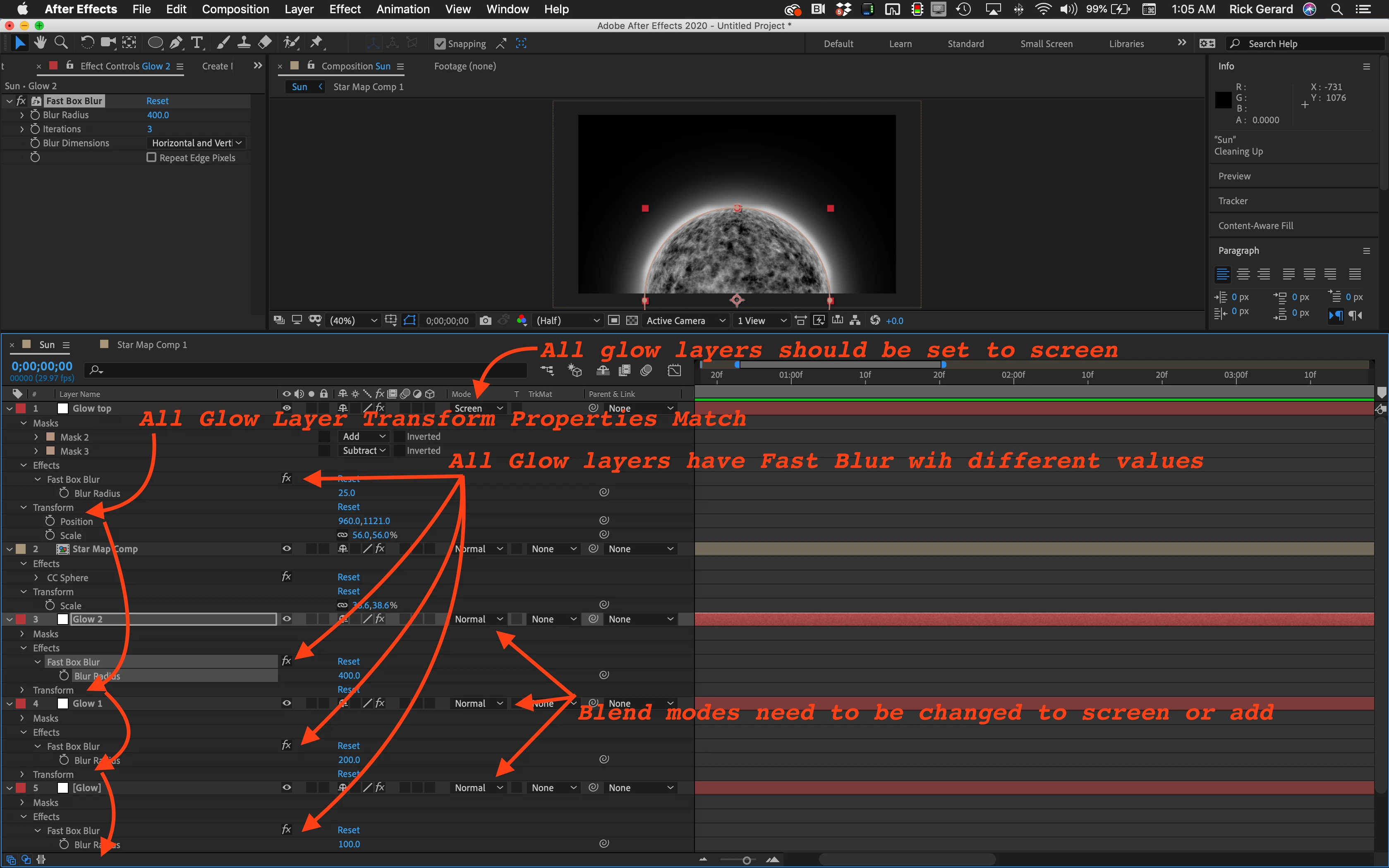

When you get something like this you can add a blur to soften the outside edge. Once you have that done turn on all the other layers, verify that all the Glow layers have blur applied and that the blend mode is set to screen. I've not set the blend mode to screen on all of the glow layers yet.

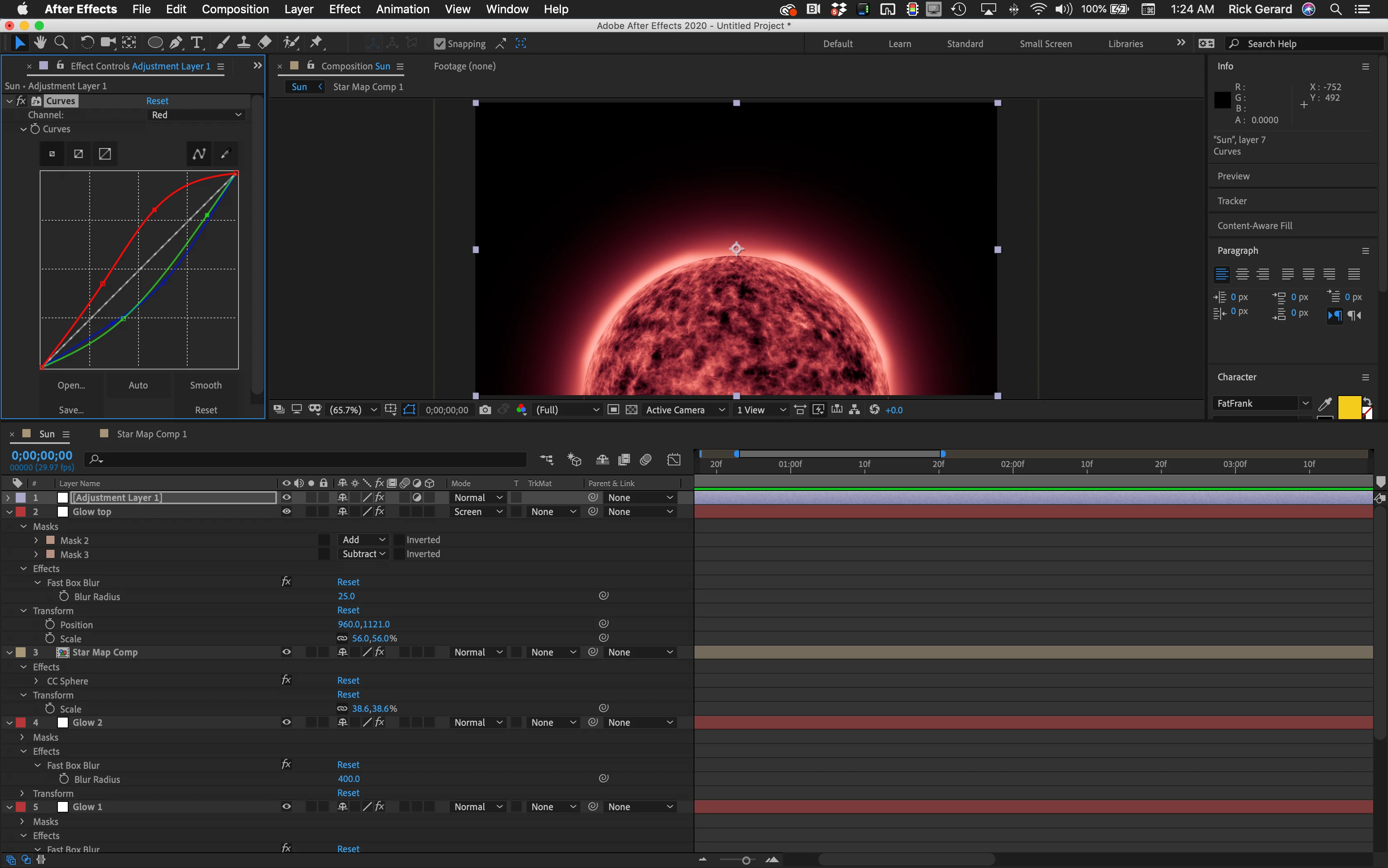

When you get that far you should see your Sun Sphere layer with a soft white glow. If you can get that far then adding an adjustment layer will allow you to change the colors of everything. You should be on your way. As long as you are using the Classic 3D rendering option Effects will work on the 3D layers and you will be able to see the blur that acts like a glow.
